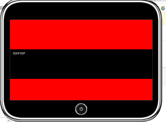

menu_para.hWinIndex = WM_CreateWindowAsChild(
        0,
        0,
        480,
        272,
        WM_HBKWIN, WM_CF_SHOW | WM_CF_MEMDEV, _cbWindow, 5);
    WM_CreateWindowAsChild(0,
        100,
        480,
        100,
        menu_para.hWinIndex,
        WM_CF_SHOW | WM_CF_MEMDEV | WM_CF_MOTION_X,
        _cbWindow1,
static void _cbWindow(WM_MESSAGE * pMsg) {
    GUI_MEMDEV_Handle   hMemOld;
    static     WM_HTIMER hTimerTime;
    static     unsigned char ss;
    WM_HWIN             hWin;
    int        xSize, xStart;
    int        ySize, yStart;
    hWin = pMsg->hWin;
    switch (pMsg->MsgId) {
    case WM_DELETE:
        break;
    case WM_TOUCH:
        break;
    case WM_MOVE:
        break;
    case WM_TIMER:
        break;
    case WM_MOTION:
        break;
    case WM_CREATE:
        break;
    case WM_PAINT:
        GUI_SetColor(GUI_RED);
        GUI_FillRect(0, 0, menu_para.xSizeWin, menu_para.ySizeWin);
        break;
static void _cbWindow1(WM_MESSAGE * pMsg) {
    static     unsigned char ss, tt=0;
    WM_HWIN             hWin;
    int        xSize, xStart;
    int        ySize, yStart;
    unsigned char i;
    hWin = pMsg->hWin;
    case WM_CREATE:
        break;
    case WM_DELETE:
        break;
    case WM_TOUCH:
        break;
    case WM_MOVE:
        break;
    case WM_TIMER:
        break;
    case WM_MOTION:
        break;
    case WM_PAINT:
        GUI_Clear();
        GUI_DispStringAt("SDDFSDF", 10, 10);
        break;
在父窗口背景为红色, 子窗口想建一下背景色为透明的, 在上面贴按键, 没想到没有办法创建透时的背景色,请帮忙看看哪里有问题。

加上WM_SetHasTrans函数后就可以了,不知对不对

子窗口的WM_PAINT消息里面调用alpha设置函数
GUI_SetAlpha(0x80);
GUI_SetColor(GUI_WHITE);
GUI_Clear();
GUI_SetAlpha(0);
试试看

谢谢,测试过了,不行!

把你完整的测试代码发出来下,我给你测试个。
