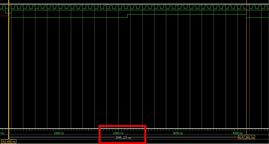

设计一个简单的1/40分频。
module verilog_prj(RESET,F10M,F500K);
input F10M,RESET;
output F500K;
reg F500K;
reg [7:0] j;
  always @(posedge F10M)
    if(!RESET)          //低电平复位。
      begin
        F500K <= 0;
        j <= 7'd0;
      end
    else
      begin
        if(j==19)      // 对计数器进行判断,以确定F500K 信号是否反转。
          begin
            j <= 7'd0;
            F500K <= ~F500K;
          end
        else
          j <= j + 1'b1;
      end
endmodule
测试模块
`timescale 1 ns/ 1 ps
module verilog_prj_vlg_tst();
// test vector input registers
reg F10M;
reg RESET;
// wires
wire F500K;
// assign statements (if any)
verilog_prj i1 (
// port map - connection between master ports and signals/registers
    .F10M(F10M),
    .F500K(F500K),
    .RESET(RESET)
always #50   F10M  =  ~ F10M;
initial
  begin
  RESET=1;
  F10M=0;
  #100 RESET=0;
  #100 RESET=1;
  #10000 $stop;
  end
endmodule
