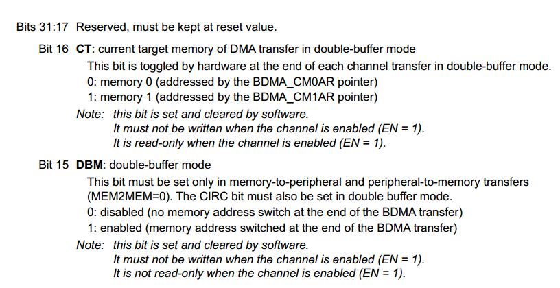

[HAL] STM32H7的HAL库BDMA寄存器CCR寄存器位没有定义全,双缓冲bit没给定义
107221
发表于 2019-1-14 02:52:37 | 显示全部楼层 |阅读模式
CCR寄存器的BIT15和BIT16
CCR寄存器的BIT0 -BIT14如下,而BIT15和BIT16未定义。
手动补上一个吧。
  1. /*******************  Bit definition for BDMA_CCR register  ********************/

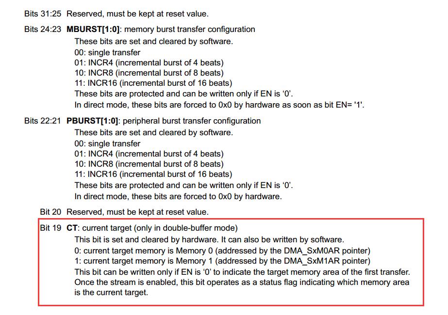

另外的两个DMA1和DMA2无此问题。
  1. /********************  Bits definition for DMA_SxCR register  *****************/
  2. #define DMA_SxCR_MBURST_Pos      (23U)
  3. #define DMA_SxCR_MBURST_Msk      (0x3U << DMA_SxCR_MBURST_Pos)                 /*!< 0x01800000 */
  4. #define DMA_SxCR_MBURST          DMA_SxCR_MBURST_Msk                           /*!< Memory burst transfer configuration */
  5. #define DMA_SxCR_MBURST_0        (0x1U << DMA_SxCR_MBURST_Pos)                 /*!< 0x00800000 */
  6. #define DMA_SxCR_MBURST_1        (0x2U << DMA_SxCR_MBURST_Pos)                 /*!< 0x01000000 */
  7. #define DMA_SxCR_PBURST_Pos      (21U)
  8. #define DMA_SxCR_PBURST_Msk      (0x3U << DMA_SxCR_PBURST_Pos)                 /*!< 0x00600000 */
  9. #define DMA_SxCR_PBURST          DMA_SxCR_PBURST_Msk                           /*!< Peripheral burst transfer configuration */
  10. #define DMA_SxCR_PBURST_0        (0x1U << DMA_SxCR_PBURST_Pos)                 /*!< 0x00200000 */
  11. #define DMA_SxCR_PBURST_1        (0x2U << DMA_SxCR_PBURST_Pos)                 /*!< 0x00400000 */
  12. #define DMA_SxCR_CT_Pos          (19U)
  13. #define DMA_SxCR_CT_Msk          (0x1U << DMA_SxCR_CT_Pos)                     /*!< 0x00080000 */
  14. #define DMA_SxCR_CT              DMA_SxCR_CT_Msk                               /*!< Current target (only in double buffer mode) */
  15. #define DMA_SxCR_DBM_Pos         (18U)
  16. #define DMA_SxCR_DBM_Msk         (0x1U << DMA_SxCR_DBM_Pos)                    /*!< 0x00040000 */
  17. #define DMA_SxCR_DBM             DMA_SxCR_DBM_Msk                              /*!< Double buffer mode */
  18. #define DMA_SxCR_PL_Pos          (16U)
  19. #define DMA_SxCR_PL_Msk          (0x3U << DMA_SxCR_PL_Pos)                     /*!< 0x00030000 */
  20. #define DMA_SxCR_PL              DMA_SxCR_PL_Msk                               /*!< Priority level */
  21. #define DMA_SxCR_PL_0            (0x1U << DMA_SxCR_PL_Pos)                     /*!< 0x00010000 */
  22. #define DMA_SxCR_PL_1            (0x2U << DMA_SxCR_PL_Pos)                     /*!< 0x00020000 */
  23. #define DMA_SxCR_PINCOS_Pos      (15U)
  24. #define DMA_SxCR_PINCOS_Msk      (0x1U << DMA_SxCR_PINCOS_Pos)                 /*!< 0x00008000 */
  25. #define DMA_SxCR_PINCOS          DMA_SxCR_PINCOS_Msk                           /*!< Peripheral increment offset size */
  26. #define DMA_SxCR_MSIZE_Pos       (13U)
  27. #define DMA_SxCR_MSIZE_Msk       (0x3U << DMA_SxCR_MSIZE_Pos)                  /*!< 0x00006000 */
  28. #define DMA_SxCR_MSIZE           DMA_SxCR_MSIZE_Msk                            /*!< Memory data size */
  29. #define DMA_SxCR_MSIZE_0         (0x1U << DMA_SxCR_MSIZE_Pos)                  /*!< 0x00002000 */
  30. #define DMA_SxCR_MSIZE_1         (0x2U << DMA_SxCR_MSIZE_Pos)                  /*!< 0x00004000 */
  31. #define DMA_SxCR_PSIZE_Pos       (11U)
  32. #define DMA_SxCR_PSIZE_Msk       (0x3U << DMA_SxCR_PSIZE_Pos)                  /*!< 0x00001800 */
  33. #define DMA_SxCR_PSIZE           DMA_SxCR_PSIZE_Msk                            /*< Peripheral data size */
  34. #define DMA_SxCR_PSIZE_0         (0x1U << DMA_SxCR_PSIZE_Pos)                  /*!< 0x00000800 */
  35. #define DMA_SxCR_PSIZE_1         (0x2U << DMA_SxCR_PSIZE_Pos)                  /*!< 0x00001000 */
  36. #define DMA_SxCR_MINC_Pos        (10U)
  37. #define DMA_SxCR_MINC_Msk        (0x1U << DMA_SxCR_MINC_Pos)                   /*!< 0x00000400 */
  38. #define DMA_SxCR_MINC            DMA_SxCR_MINC_Msk                             /*!< Memory increment mode */
  39. #define DMA_SxCR_PINC_Pos        (9U)
  40. #define DMA_SxCR_PINC_Msk        (0x1U << DMA_SxCR_PINC_Pos)                   /*!< 0x00000200 */
  41. #define DMA_SxCR_PINC            DMA_SxCR_PINC_Msk                             /*!< Peripheral increment mode */
  42. #define DMA_SxCR_CIRC_Pos        (8U)
  43. #define DMA_SxCR_CIRC_Msk        (0x1U << DMA_SxCR_CIRC_Pos)                   /*!< 0x00000100 */
  44. #define DMA_SxCR_CIRC            DMA_SxCR_CIRC_Msk                             /*!< Circular mode */
  45. #define DMA_SxCR_DIR_Pos         (6U)
  46. #define DMA_SxCR_DIR_Msk         (0x3U << DMA_SxCR_DIR_Pos)                    /*!< 0x000000C0 */
  47. #define DMA_SxCR_DIR             DMA_SxCR_DIR_Msk                              /*!< Data transfer direction */
  48. #define DMA_SxCR_DIR_0           (0x1U << DMA_SxCR_DIR_Pos)                    /*!< 0x00000040 */
  49. #define DMA_SxCR_DIR_1           (0x2U << DMA_SxCR_DIR_Pos)                    /*!< 0x00000080 */
  50. #define DMA_SxCR_PFCTRL_Pos      (5U)
  51. #define DMA_SxCR_PFCTRL_Msk      (0x1U << DMA_SxCR_PFCTRL_Pos)                 /*!< 0x00000020 */
  52. #define DMA_SxCR_PFCTRL          DMA_SxCR_PFCTRL_Msk                           /*!< Peripheral flow controller */
  53. #define DMA_SxCR_TCIE_Pos        (4U)
  54. #define DMA_SxCR_TCIE_Msk        (0x1U << DMA_SxCR_TCIE_Pos)                   /*!< 0x00000010 */
  55. #define DMA_SxCR_TCIE            DMA_SxCR_TCIE_Msk                             /*!< Transfer complete interrupt enable */
  56. #define DMA_SxCR_HTIE_Pos        (3U)
  57. #define DMA_SxCR_HTIE_Msk        (0x1U << DMA_SxCR_HTIE_Pos)                   /*!< 0x00000008 */
  58. #define DMA_SxCR_HTIE            DMA_SxCR_HTIE_Msk                             /*!< Half transfer interrupt enable */
  59. #define DMA_SxCR_TEIE_Pos        (2U)
  60. #define DMA_SxCR_TEIE_Msk        (0x1U << DMA_SxCR_TEIE_Pos)                   /*!< 0x00000004 */
  61. #define DMA_SxCR_TEIE            DMA_SxCR_TEIE_Msk                             /*!< Transfer error interrupt enable */
  62. #define DMA_SxCR_DMEIE_Pos       (1U)
  63. #define DMA_SxCR_DMEIE_Msk       (0x1U << DMA_SxCR_DMEIE_Pos)                  /*!< 0x00000002 */
  64. #define DMA_SxCR_DMEIE           DMA_SxCR_DMEIE_Msk                            /*!< Direct mode error interrupt enable */
  65. #define DMA_SxCR_EN_Pos          (0U)
  66. #define DMA_SxCR_EN_Msk          (0x1U << DMA_SxCR_EN_Pos)                     /*!< 0x00000001 */
  67. #define DMA_SxCR_EN              DMA_SxCR_EN_Msk                               /*!< Stream enable / flag stream ready when read low */
