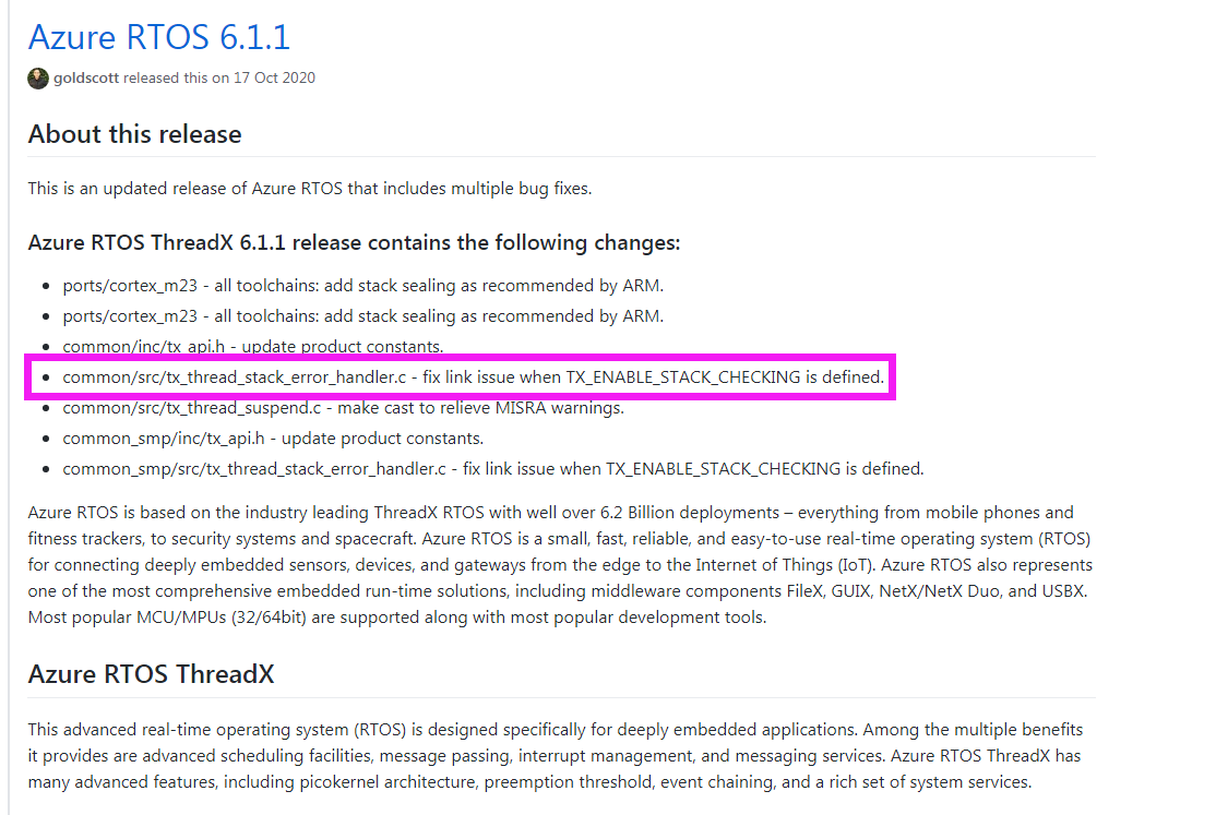

[ThreadX全家桶] ThreadX使用早期的内核版本开栈检测TX_ENABLE_STACK_CHECKING很多错误,升级到最新的6.1.6即可

发现是在这个版本解决的:

 楼主| 发表于 2021-4-20 17:08:06 | 显示全部楼层
/* Determine whether or not stack checking is enabled. By default, ThreadX stack checking is
   disabled. When the following is defined, ThreadX thread stack checking is enabled.  If stack
   checking is enabled (TX_ENABLE_STACK_CHECKING is defined), the TX_DISABLE_STACK_FILLING
   define is negated, thereby forcing the stack fill which is necessary for the stack checking
   logic.  */
#ifndef TX_MISRA_ENABLE
#ifdef TX_ENABLE_STACK_CHECKING
#undef TX_DISABLE_STACK_FILLING
#endif
#endif
看来版本还是使用新的好哇
