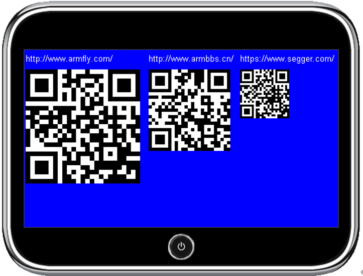

发表于 2021-6-12 15:33:03 | 显示全部楼层 |阅读模式
代码:
  1. #include "GUI.h"
  2. /*********************************************************************
  3. *
  4. *       MainTask
  5. */
  6. void MainTask(void)
  7. {
  8.     GUI_HMEM hMem, hMem1, hMem2;
  9.     GUI_Init();
  10.     GUI_SetBkColor(GUI_BLUE);
  11.     GUI_Clear();
  12.     GUI_SetColor(GUI_WHITE);
  13.     GUI_SetFont(&GUI_Font16_1);
  14.     GUI_DispStringAt("http://www.armfly.com/", 2, 5);
  15.     hMem = GUI_QR_Create("http://www.armfly.com/", 7, GUI_QR_ECLEVEL_L, 0);
  16.     GUI_QR_Draw(hMem, 2, 30);
  17.     GUI_DispStringAt("http://www.armbbs.cn/", 190, 5);
  18.     hMem1 = GUI_QR_Create("http://www.armbbs.cn/", 5, GUI_QR_ECLEVEL_L, 0);
  19.     GUI_QR_Draw(hMem1, 190, 30);
  20.     GUI_DispStringAt("https://www.segger.com/", 330, 5);
  21.     hMem2 = GUI_QR_Create("https://www.segger.com/", 3, GUI_QR_ECLEVEL_L, 0);
  22.     GUI_QR_Draw(hMem2, 330, 30);
  23.     while (1)
  24.     {
  25.         GUI_Delay(10);
  26.     }
  27. }
