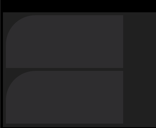

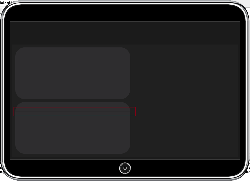

[emWin] emWin在模拟器用WM_CreateWindowAsChild创建的窗口里面都带有一条横线,请问这种情况是怎么回事呢?
50
77
77
发表于 2021-8-30 10:07:50 | 显示全部楼层 |阅读模式
#include "DIALOG.h"
#define ID_WINDOW_0    (GUI_ID_USER + 0x07)
#define ID_WINDOW_1    (GUI_ID_USER + 0x08)
#define TEXT_X_SIZE    200
#define TEXT_Y_SIZE    45
#define X_LCD_SIZE     800
#define Y_LCD_SIZE     480
#define TEXT_X_POS     ((X_LCD_SIZE-TEXT_X_SIZE)/2)
#define TEXT_Y_POS     ((Y_LCD_SIZE-TEXT_Y_SIZE)/2+150)
#define MAG          3
  { WINDOW_CreateIndirect, "App_Startup", ID_WINDOW_0, 8, 80, X_LCD_SIZE-16, Y_LCD_SIZE-88, 0, 0x0, 0 },
extern GUI_CONST_STORAGE GUI_BITMAP bmAllOptomedic;
extern GUI_CONST_STORAGE GUI_BITMAP bmbackLogoWord;
extern GUI_CONST_STORAGE GUI_BITMAP bmbackLogoColorCircle24;
extern GUI_CONST_STORAGE GUI_BITMAP bmcolortOptomedicLogo;
extern GUI_CONST_STORAGE GUI_BITMAP bmoptomedicbig;
  WM_HWIN hItem;
  WM_HWIN hWin;
  WM_HTIMER hTimer;
  GUI_RECT Rect;
  hWin = pMsg->hWin;
  switch (pMsg->MsgId)
        case WM_INIT_DIALOG:
                WINDOW_SetBkColor(hWin, GUI_MAKE_COLOR(0x00202020));
                hTimer = WM_CreateTimer(hWin, 0, 500, 0);
                break;
        case WM_PAINT:
#if 0
                GUI_SetColor(GUI_MAKE_COLOR(0x00202020));
                WM_GetClientRect(&Rect);
//                WM_GetWindowRect(&Rect);
                GUI_AA_FillRoundedRect(Rect.x0*3, Rect.y0*3, Rect.x1*3, Rect.y1*3, 20);
                GUI_SetColor(GUI_WHITE);
#endif
//                WM_GetClientRect(&Rect);
//                GUI_DrawGradientV(Rect.x0, Rect.y0, Rect.x1,  Rect.y1,  GUI_MAKE_COLOR(0x00202020), GUI_MAKE_COLOR(0x00202020));
                break;
         case WM_TIMER:
                 break;
  default:
    WM_DefaultProc(pMsg);
    break;
static void _cbDialogPressureWin(WM_MESSAGE * pMsg)
     GUI_RECT pRect;
     char buf[40];
          case WM_TIMER:
                    WM_InvalidateWindow(pMsg->hWin);
                    WM_RestartTimer(pMsg->Data.v, 1000);
                    break;
            case WM_PAINT:
                                GUI_SetColor(GUI_MAKE_COLOR(0x002F2D2E));
                                WM_GetClientRect(&pRect);
//                                WM_GetWindowRect(&pRect);
                                GUI_AA_FillRoundedRect(pRect.x0*MAG, pRect.y0*MAG, pRect.x1*MAG, pRect.y1*MAG, 100);
                                break;
                case WM_CREATE:
                                /* 设置抗锯齿因数 */
//                                GUI_AA_SetFactor(MAG);
//                                WM_CreateTimer(pMsg->hWin, 0, 1000, 0);
                                break;
                default:
                                break;
static void _cbDialogFlowWin(WM_MESSAGE * pMsg)
     GUI_RECT pRect;
     char buf[40];
          case WM_TIMER:
                    break;
            case WM_PAINT:
                                break;
                case WM_CREATE:
                                /* 设置抗锯齿因数 */
                                break;
                default:
                                break;
WM_HWIN CreateApp_Startup(void)
  WM_HWIN hWin;
  WM_HWIN hWin1;
  WM_SetHasTrans(hWin);
//  WM_SetCallback(hWin, _cbDialogNew);
//hWin =  WM_CreateWindowAsChild(8,
//                   50,
//                   800-20,
//                   420,
//                         WM_HBKWIN,
//                   WM_CF_SHOW | WM_CF_HASTRANS,
//                  _cbDialog,
//                  0);
#if 1
   hWin1 =  WM_CreateWindowAsChild(10,
                     10,
                     400,
                     180,
                                         hWin,
                    _cbDialogPressureWin,
                    0);
   WM_SetHasTrans(hWin1);
                     200,
                     400,
                     180,
                                         hWin,
                    _cbDialogFlowWin,
                    0);
#endif
        return hWin;
115812

 楼主| 发表于 2021-8-30 11:31:12 | 显示全部楼层
也是模拟器测的么?不知道为啥我这显示就是有一条线,难道是模拟器的bug么
115812
发表于 2021-8-30 14:20:56 | 显示全部楼层
是的。
