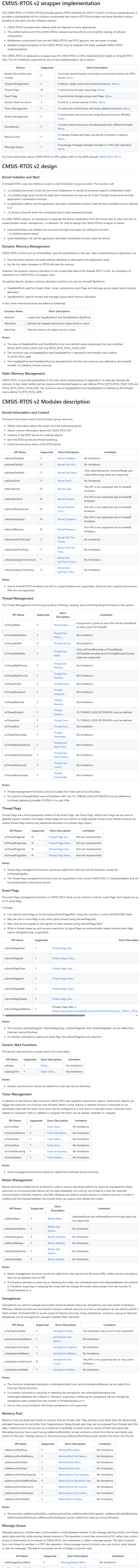

(1)ST升级ThreadX的CMSIS-RTOS V2封装层API
https://github.com/STMicroelectronics/STM32CubeU5/tree/main/Middlewares/ST/cmsis_rtos_threadx
当前支持情况整理:
