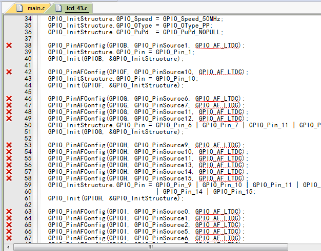

我是用keil5大家帮忙看看,这是怎么回事,编译提示:
..\drivers\stm32f4xx.h(80): error:  #35: #error directive: &quotlease select first the target STM32F4xx device used in your application (in stm32f4xx.h file)"
   #error &quotlease select first the target STM32F4xx device used in your application (in stm32f4xx.h file)"

看错误说明是因为你没有在option的C/C++的预编译里面添加STM32F4类型。这个要添加的。
