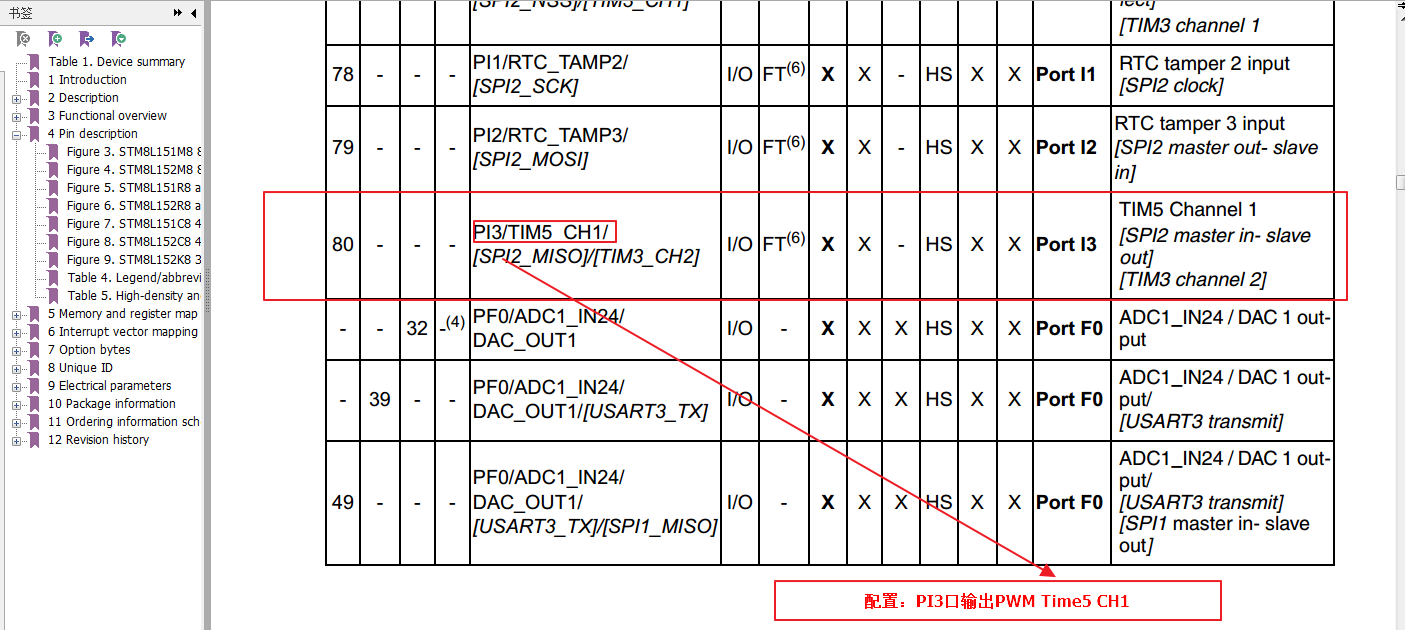

STM8L152M8 单片机 怎么输出不了PWM
发表于 2017-3-3 20:15:28 | 显示全部楼层 |阅读模式
static void TIM5_Config(void)
   /* Enable TIM5 clock */
   CLK_PeripheralClockConfig(CLK_Peripheral_TIM5, ENABLE);
   /* TIM5 Channel1 configuration: PI3 */
   GPIO_Init(GPIOI, GPIO_Pin_3, GPIO_Mode_Out_PP_High_Slow);
   - TIM1CLK = 2 MHz
  - TIM1 counter clock = TIM1CLK / TIM1_PRESCALER+1 = 2 MHz/1+1 = 1 MHz
   /* Time base configuration */
   TIM5_TimeBaseInit(TIM5_Prescaler_1, TIM5_CounterMode_Up, 65535);
   TIM5_OC1Init(TIM5_OCMode_PWM1, TIM5_OutputState_Enable, CCR1_Val, TIM5_OCPolarity_High,
                TIM5_OCIdleState_Set);
   TIM5_OC1PreloadConfig(ENABLE);
   TIM5_ARRPreloadConfig(ENABLE);
   TIM5_CtrlPWMOutputs(ENABLE);
   TIM5_Cmd(ENABLE);
发表于 2017-3-4 09:40:05 | 显示全部楼层
没用过STM8,帮顶。
ps:官方STM8库里面应该有例子的,对比设置下。
发表于 2017-5-3 20:29:16 | 显示全部楼层
I3管脚要设置成输出
