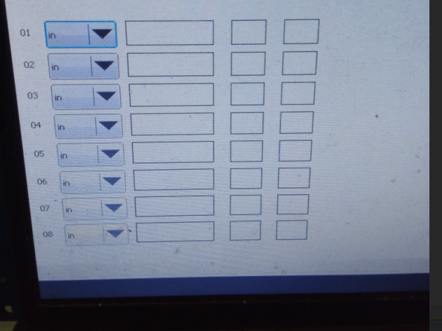

gui内存为14m,VRAM内存为2m,界面任务栈为8k,资源应该足够了,为何还是创建32个以上小工具就会死掉?

 楼主| 发表于 2018-5-11 15:09:40 | 显示全部楼层
#define ID_WINDOW_0 (GUI_ID_USER + 0x00)
#define ID_DROPDOWN_0 (GUI_ID_USER + 0x01)
#define ID_DROPDOWN_1 (GUI_ID_USER + 0x02)
#define ID_DROPDOWN_2 (GUI_ID_USER + 0x03)
#define ID_DROPDOWN_3 (GUI_ID_USER + 0x04)
#define ID_DROPDOWN_4 (GUI_ID_USER + 0x05)
#define ID_DROPDOWN_5 (GUI_ID_USER + 0x06)
#define ID_DROPDOWN_6 (GUI_ID_USER + 0x07)
#define ID_DROPDOWN_7 (GUI_ID_USER + 0x08)
#define ID_TEXT_0 (GUI_ID_USER + 0x0b)
#define ID_TEXT_1 (GUI_ID_USER + 0x0c)
#define ID_TEXT_2 (GUI_ID_USER + 0x0d)
#define ID_TEXT_3 (GUI_ID_USER + 0x0e)
#define ID_TEXT_4 (GUI_ID_USER + 0x0f)
#define ID_TEXT_5 (GUI_ID_USER + 0x10)
#define ID_TEXT_6 (GUI_ID_USER + 0x11)
#define ID_TEXT_7 (GUI_ID_USER + 0x12)
#define ID_EDIT_0 (GUI_ID_USER + 0x18)
#define ID_EDIT_1 (GUI_ID_USER + 0x19)
#define ID_EDIT_2 (GUI_ID_USER + 0x1a)
#define ID_EDIT_3 (GUI_ID_USER + 0x1b)
#define ID_EDIT_4 (GUI_ID_USER + 0x1c)
#define ID_EDIT_5 (GUI_ID_USER + 0x1d)
#define ID_EDIT_6 (GUI_ID_USER + 0x1e)
#define ID_EDIT_7 (GUI_ID_USER + 0x1f)
#define ID_EDIT_8 (GUI_ID_USER + 0x20)
#define ID_EDIT_9 (GUI_ID_USER + 0x21)
#define ID_EDIT_10 (GUI_ID_USER + 0x22)
#define ID_EDIT_11 (GUI_ID_USER + 0x23)
#define ID_EDIT_12 (GUI_ID_USER + 0x24)
#define ID_EDIT_13 (GUI_ID_USER + 0x25)
#define ID_EDIT_14 (GUI_ID_USER + 0x26)
#define ID_EDIT_15 (GUI_ID_USER + 0x27)
#define ID_EDIT_16 (GUI_ID_USER + 0x28)
#define ID_EDIT_17 (GUI_ID_USER + 0x29)
#define ID_EDIT_18 (GUI_ID_USER + 0x2a)
#define ID_EDIT_19 (GUI_ID_USER + 0x2b)
#define ID_EDIT_20 (GUI_ID_USER + 0x2c)
#define ID_EDIT_21 (GUI_ID_USER + 0x2d)
#define ID_EDIT_22 (GUI_ID_USER + 0x2e)
#define ID_EDIT_23 (GUI_ID_USER + 0x2f)
#define ID_EDIT_24 (GUI_ID_USER + 0x28)
#define ID_EDIT_25 (GUI_ID_USER + 0x29)
#define ID_EDIT_26 (GUI_ID_USER + 0x2a)
#define ID_EDIT_27 (GUI_ID_USER + 0x2b)
#define ID_EDIT_28 (GUI_ID_USER + 0x2c)
#define ID_EDIT_29 (GUI_ID_USER + 0x2d)
#define ID_EDIT_30 (GUI_ID_USER + 0x2e)
#define ID_EDIT_31 (GUI_ID_USER + 0x2f)
#define ID_BUTTON_0 (GUI_ID_USER + 0x31)
#define ID_BUTTON_1 (GUI_ID_USER + 0x32)
#define ID_BUTTON_2 (GUI_ID_USER + 0x33)
#define ID_BUTTON_3 (GUI_ID_USER + 0x34)
#define ID_BUTTON_4 (GUI_ID_USER + 0x35)
#define ID_BUTTON_5 (GUI_ID_USER + 0x36)
#define ID_BUTTON_6 (GUI_ID_USER + 0x37)
#define ID_BUTTON_7 (GUI_ID_USER + 0x38)
#define ID_BUTTON_8 (GUI_ID_USER + 0x39)
#define ID_BUTTON_9 (GUI_ID_USER + 0x40)
#define ID_BUTTON_10 (GUI_ID_USER + 0x41)
#define ID_BUTTON_11 (GUI_ID_USER + 0x42)
#define ID_BUTTON_12 (GUI_ID_USER + 0x43)
#define ID_BUTTON_13 (GUI_ID_USER + 0x44)
#define ID_BUTTON_14 (GUI_ID_USER + 0x45)
#define ID_BUTTON_15 (GUI_ID_USER + 0x46)
#define ID_PROGBAR_0 (GUI_ID_USER + 0x47)
static const GUI_WIDGET_CREATE_INFO _aDialogCreate[] =
    { WINDOW_CreateIndirect, "Window", ID_WINDOW_0, 0, 0, 800, 450, 0, 0x0, 0 },
    { DROPDOWN_CreateIndirect, "Dropdown", ID_DROPDOWN_0, 40, 90, 80, 55, 0, 0x0, 0 },
    { DROPDOWN_CreateIndirect, "Dropdown", ID_DROPDOWN_1, 40, 129, 80, 55, 0, 0x0, 0 },
    { DROPDOWN_CreateIndirect, "Dropdown", ID_DROPDOWN_2, 40, 168, 80, 55, 0, 0x0, 0 },
    { DROPDOWN_CreateIndirect, "Dropdown", ID_DROPDOWN_3, 40, 207, 80, 55, 0, 0x0, 0 },
    { DROPDOWN_CreateIndirect, "Dropdown", ID_DROPDOWN_4, 40, 246, 80, 55, 0, 0x0, 0 },
    { DROPDOWN_CreateIndirect, "Dropdown", ID_DROPDOWN_5, 40, 285, 80, 55, 0, 0x0, 0 },
    { DROPDOWN_CreateIndirect, "Dropdown", ID_DROPDOWN_6, 40, 324, 80, 55, 0, 0x0, 0 },
    { DROPDOWN_CreateIndirect, "Dropdown", ID_DROPDOWN_7, 40, 363, 80, 55, 0, 0x0, 0 },
    { TEXT_CreateIndirect, " ", ID_TEXT_0, 10, 90, 20, 28, 0, 0x0, 0 },
    { TEXT_CreateIndirect, " ", ID_TEXT_1, 10, 129, 20, 28, 0, 0x0, 0 },
    { TEXT_CreateIndirect, " ", ID_TEXT_2, 10, 168, 20, 28, 0, 0x0, 0 },
    { TEXT_CreateIndirect, " ", ID_TEXT_3, 10, 207, 20, 28, 0, 0x0, 0 },
    { TEXT_CreateIndirect, " ", ID_TEXT_4, 10, 246, 20, 28, 0, 0x0, 0 },
    { TEXT_CreateIndirect, " ", ID_TEXT_5, 10, 285, 20, 28, 0, 0x0, 0 },
    { TEXT_CreateIndirect, " ", ID_TEXT_6, 10, 324, 20, 28, 0, 0x0, 0 },
    { TEXT_CreateIndirect, " ", ID_TEXT_7, 10, 363, 20, 28, 0, 0x0, 0 },
    { EDIT_CreateIndirect, "Edit", ID_EDIT_0, 130, 90, 100, 30, 0, 0x10, 0 },
    { EDIT_CreateIndirect, "Edit", ID_EDIT_1, 130, 129, 100, 30, 0, 0x10, 0 },
    { EDIT_CreateIndirect, "Edit", ID_EDIT_2, 130, 168, 100, 30, 0, 0x10, 0 },
    { EDIT_CreateIndirect, "Edit", ID_EDIT_3, 130, 207, 100, 30, 0, 0x10, 0 },
    { EDIT_CreateIndirect, "Edit", ID_EDIT_4, 130, 246, 100, 30, 0, 0x10, 0 },
    { EDIT_CreateIndirect, "Edit", ID_EDIT_5, 130, 285, 100, 30, 0, 0x10, 0 },
    { EDIT_CreateIndirect, "Edit", ID_EDIT_6, 130, 324, 100, 30, 0, 0x10, 0 },
    { EDIT_CreateIndirect, "Edit", ID_EDIT_7, 130, 363, 100, 30, 0, 0x10, 0 },
    { EDIT_CreateIndirect, "Edit", ID_EDIT_8, 250, 90, 40, 30, 0, 0x10, 0 },
    { EDIT_CreateIndirect, "Edit", ID_EDIT_9, 250, 129, 40, 30, 0, 0x10, 0 },
    { EDIT_CreateIndirect, "Edit", ID_EDIT_10, 250, 168, 40, 30, 0, 0x10, 0 },
    { EDIT_CreateIndirect, "Edit", ID_EDIT_11, 250, 207, 40, 30, 0, 0x10, 0 },
    { EDIT_CreateIndirect, "Edit", ID_EDIT_12, 250, 246, 40, 30, 0, 0x10, 0 },
    { EDIT_CreateIndirect, "Edit", ID_EDIT_13, 250, 285, 40, 30, 0, 0x10, 0 },
    { EDIT_CreateIndirect, "Edit", ID_EDIT_14, 250, 324, 40, 30, 0, 0x10, 0 },
    { EDIT_CreateIndirect, "Edit", ID_EDIT_15, 250, 363, 40, 30, 0, 0x10, 0 },
    { EDIT_CreateIndirect, "Edit", ID_EDIT_16, 310, 90, 40, 30, 0, 0x10, 0 },
    { EDIT_CreateIndirect, "Edit", ID_EDIT_17, 310, 129, 40, 30, 0, 0x10, 0 },
    { EDIT_CreateIndirect, "Edit", ID_EDIT_18, 310, 168, 40, 30, 0, 0x10, 0 },
    { EDIT_CreateIndirect, "Edit", ID_EDIT_19, 310, 207, 40, 30, 0, 0x10, 0 },
    { EDIT_CreateIndirect, "Edit", ID_EDIT_20, 310, 246, 40, 30, 0, 0x10, 0 },
    { EDIT_CreateIndirect, "Edit", ID_EDIT_21, 310, 285, 40, 30, 0, 0x10, 0 },
    { EDIT_CreateIndirect, "Edit", ID_EDIT_22, 310, 324, 40, 30, 0, 0x10, 0 },
    { EDIT_CreateIndirect, "Edit", ID_EDIT_23, 310, 363, 40, 30, 0, 0x10, 0 },
    { PROGBAR_CreateIndirect, "Progbar", ID_PROGBAR_0, 0, 445, 800, 5, 0, 0x0, 0 },

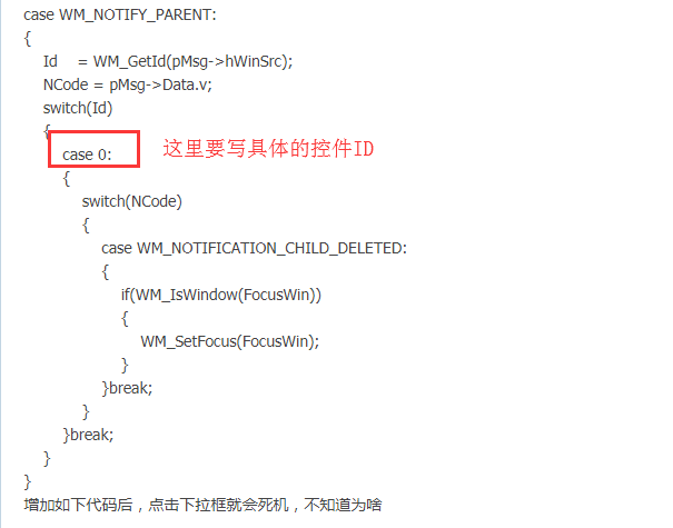

另外,发现个问题
case WM_NOTIFY_PARENT:
    Id    = WM_GetId(pMsg->hWinSrc);
    NCode = pMsg->Data.v;
    switch(Id)
        case 0:
            switch(NCode)
                case WM_NOTIFICATION_CHILD_DELETED:
                    if(WM_IsWindow(FocusWin))
                        WM_SetFocus(FocusWin);
                }break;
        }break;
增加如下代码后,点击下拉框就会死机,不知道为啥

发表于 2018-5-17 00:41:53 | 显示全部楼层
xiaolun217001 发表于 2018-5-16 10:26
另外,发现个问题
这个是增加到哪里的代码。
38
91
205
205
 楼主| 发表于 2018-5-17 11:13:39 | 显示全部楼层
           //这个地方
            break;

 楼主| 发表于 2018-5-18 10:59:49 | 显示全部楼层
为啥,如果不用下拉控件,就没有问题,这个消息是删除子窗口时发送的,应该是emwin本身填写的

发表于 2018-5-19 01:32:22 | 显示全部楼层
对应控件处理对应的消息。
