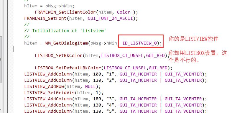

[emWin] LISTBOX_SetBkColor();函数在仿真中无法调用

代码如下

    hItem = pMsg->hWin;
        FRAMEWIN_SetClientColor(hItem, Color );
    FRAMEWIN_SetFont(hItem, GUI_FONT_24_ASCII);
    // Initialization of 'Listview'
    hItem = WM_GetDialogItem(pMsg->hWin, ID_LISTVIEW_0);
        LISTBOX_SetBkColor(hItem,LISTBOX_CI_UNSEL,GUI_RED);
        LISTBOX_SetDefaultBkColor(LISTBOX_CI_UNSEL,GUI_RED);
    LISTVIEW_AddColumn(hItem, 100, "1", GUI_TA_HCENTER | GUI_TA_VCENTER);

发表于 2019-4-27 00:28:32 | 显示全部楼层
