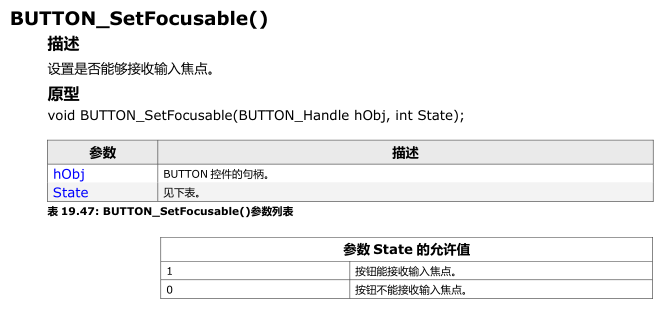

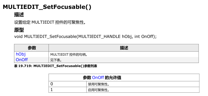

在使用emwin时,经常需要临时或者某些切换时 失能指定的widget的焦点
emwin设置焦点:
  1. WM_SetFocus(_hMenu)
emwin失能焦点好像忘了,根据“板凳”楼层兄弟的提示,我复习了一下:
  1. void BUTTON_SetFocusable(BUTTON_Handle hObj, int State)
  1. void EDIT_SetFocusable(EDIT_Handle hObj, int State)
  1. void MULTIEDIT_SetFocusable(MULTIEDIT_HANDLE hObj, int OnOff);

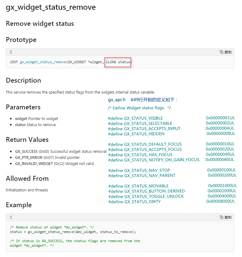

GUIX设置控件焦点:
  1. gx_widget_status_add(GX_WIDGET *widget, GX_STATUS_ACCEPTS_FOCUS)
函数原型:
  1. UINT gx_widget_status_add(GX_WIDGET *widget, ULONG status)
GUIX失能控件焦点:
  1. gx_widget_status_remove(GX_WIDGET *widget, GX_STATUS_ACCEPTS_FOCUS)
函数原型:
  1. UINT gx_widget_status_remove(GX_WIDGET *widget, ULONG status)
status flags丰富不丰富:
  1. /* Define Widget status flags.  */
  2. #define GX_STATUS_VISIBLE                   0x00000001UL
  3. #define GX_STATUS_SELECTABLE                0x00000002UL
  4. #define GX_STATUS_ACCEPTS_INPUT             0x00000004UL
  5. #define GX_STATUS_HIDDEN                    0x00000008UL
  6. #define GX_STATUS_DEFAULT_FOCUS             0x00000010UL
  7. #define GX_STATUS_ACCEPTS_FOCUS             0x00000020UL
  8. #define GX_STATUS_HAS_FOCUS                 0x00000040UL
  9. #define GX_STATUS_NOTIFY_ON_GAIN_FOCUS      0x00000080UL
  10. #define GX_STATUS_NAV_STOP                  0x00000100UL
  11. #define GX_STATUS_NAV_PARENT                0x00000200UL
  12. #define GX_STATUS_MOVABLE                   0x00001000UL
  13. #define GX_STATUS_BUTTON_DERIVED            0x00002000UL
  14. #define GX_STATUS_TOGGLE_UNLOCK             0x00004000UL
  15. #define GX_STATUS_DIRTY                     0x00008000UL
  16. /* define cursor status flags */
  17. #define GX_STATUS_CURSOR_SHOW               0x00010000UL
  18. #define GX_STATUS_CURSOR_DRAW               0x00020000UL
  19. #define GX_STATUS_MARK_PREVIOUS             0x00040000UL
  20. #define GX_STATUS_MARK_NEXT                 0x00080000UL
  21. /* Define radial slider status flags */
  22. #define GX_STATUS_ANIMATION_NONE            0x00010000UL
  23. #define GX_STATUS_TRACKING_START            0x00020000UL
  24. #define GX_STATUS_MODAL                     0x00100000UL
  25. #define GX_STATUS_LINE_BREAK_PROCESSED      0x02000000UL
  26. #define GX_STATUS_RESIZE_NOTIFY             0x04000000UL
  27. #define GX_STATUS_STUDIO_CREATED            0x08000000UL
  28. #define GX_STATUS_TRANSPARENT               0x10000000UL
  29. #define GX_STATUS_NONCLIENT                 0x20000000UL
  30. #define GX_STATUS_OWNS_INPUT                0x40000000UL
  31. #define GX_STATUS_DYNAMICALLY_ALLOCATED     0x80000000UL
焦点切换在做键盘时一定会用到。

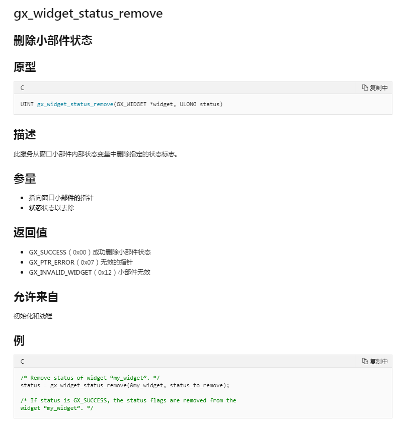

函数机翻中文
函数机翻中文
机翻了一下函数说明:
函数简介
函数简介

发表于 2020-9-27 11:27:53 | 显示全部楼层
emwin的失能焦点函数是WM_SetFocussable
22
31
31
 楼主| 发表于 2020-9-27 12:09:14 | 显示全部楼层
谢谢楼上的兄弟提示,刚才复习了一下,顺手分享出来。
BUTTON_SetFocussable函数说明

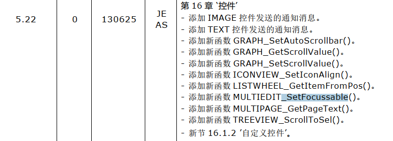

MULTIEDIT_SetFocussable函数增加的时间
MULTIEDIT_SetFocussable函数说明

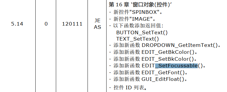

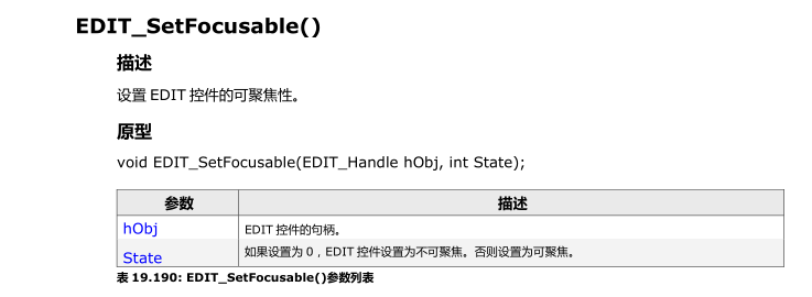

EDIT_SetFocussable说明
