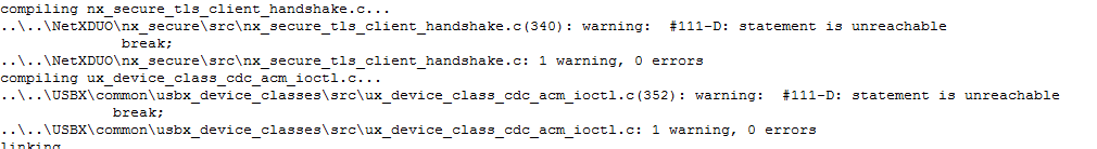

AC5警告修改
1、ux_device_class_cdc_acm_ioctl.c
        /* Declare the transmission with callback on.  */
        cdc_acm -> ux_slave_class_cdc_acm_transmission_status = UX_TRUE;
        /* We are done here.  */
        return(UX_SUCCESS);
   //break;
2、nx_secure_tls_client_handshake.c
        case NX_SECURE_TLS_CLIENT_STATE_ALERT_SENT:
                /* This means an error was encountered at some point in processing a valid message. At this point
                   the alert was sent, so just return a status indicating as much. */
                return(NX_SECURE_TLS_HANDSHAKE_FAILURE);
                //break;
3、nx_secure_crypto_rng_self_test.c
//UINT _nx_secure_crypto_rng_self_test();

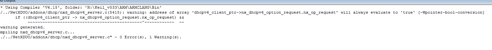

AC6警告修改
1、nxd_smtp_client.c
    /* Initialize authentication flags.  */
    carriage_return_linefeed_ptr = (CHAR)0x0;
2、nxd_ptp_client.c
    if (!(client_ptr -> nx_ptp_client_sync_flags) & NX_PTP_CLIENT_SYNC_CALIBRATED)
3、nxd_dhcpv6_server.c
        if ((dhcpv6_client_ptr -> nx_dhcpv6_option_request.nx_op_request) &&
            (dhcpv6_client_ptr -> nx_dhcpv6_iana_status.nx_status_code == NX_DHCPV6_STATUS_SUCCESS))

AC5警告:
AC6警告:
75
