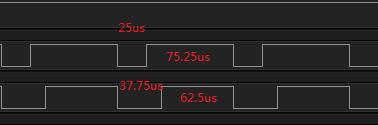

 楼主| 发表于 2021-7-8 10:26:07 | 显示全部楼层
eric2013 发表于 2021-7-7 18:04
PWM 频率 = TIMxCLK /( Prescaler + 1) /(Period+ 1)/ 2
PMW 占空比 = Pulse/(Period + 1)
非对称模式怎么计算高低电平时间呢?
htim3.Instance = TIM3;
  htim3.Init.Prescaler = 0;
  htim3.Init.CounterMode = TIM_COUNTERMODE_CENTERALIGNED1;
  htim3.Init.Period = 2800-1;
  htim3.Init.ClockDivision = TIM_CLOCKDIVISION_DIV1;
  htim3.Init.RepetitionCounter = 0;
  htim3.Init.AutoReloadPreload = TIM_AUTORELOAD_PRELOAD_DISABLE;
  if (HAL_TIM_PWM_Init(&htim3) != HAL_OK)
    Error_Handler();
        sConfigOC.OCMode = TIM_OCMODE_PWM2;
  sConfigOC.Pulse = 700;
  sConfigOC.OCPolarity = TIM_OCPOLARITY_HIGH;
  sConfigOC.OCNPolarity = TIM_OCNPOLARITY_HIGH;
  sConfigOC.OCFastMode = TIM_OCFAST_DISABLE;
  sConfigOC.OCIdleState = TIM_OCIDLESTATE_RESET;
  sConfigOC.OCNIdleState = TIM_OCNIDLESTATE_RESET;
  if (HAL_TIM_PWM_ConfigChannel(&htim3, &sConfigOC, TIM_CHANNEL_1) != HAL_OK)
    Error_Handler();
        sConfigOC.OCMode = TIM_OCMODE_ASSYMETRIC_PWM2;
  sConfigOC.Pulse = 1400;
  if(HAL_TIM_PWM_ConfigChannel(&htim3, &sConfigOC, TIM_CHANNEL_2) != HAL_OK)
    /* Configuration Error */
    Error_Handler();
图片显示抓到的波形,第一个是通道1,第二个是通道2,通道2的高低电平时间是怎么计算的?

发表于 2021-7-8 11:11:05 | 显示全部楼层
lindahnu 发表于 2021-7-8 10:26
非对称模式怎么计算高低电平时间呢?
STM32H7的非对称PWM模式(Asymmetric PWM mode),波形的相位差可编程
http://www.armbbs.cn/forum.php?m ... 9110&fromuid=58
