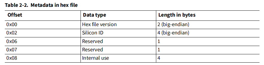

0x9050 0000 – Metadata (12 bytes): This section contains data that is not programmed into the target device.
Instead, it is used to check data integrity of the hex file and the silicon ID of the target device. Table 2-2 lists the
fields in this section.
本节包含未被编程到目标设备中的数据。相反,它被用来检查十六进制文件的数据完整性和目标设备的硅ID。
表2-2列出了本节中的各个字段。

0x9050 0000 – Metadata (12 bytes) 的格式:
Hex file version: This 2-byte field in the hex file defines its version (or type). The version for the target family
is “2”. The programmer should use this field to make sure that the hex file corresponds to the target device,
or to select the appropriate parsing algorithm if the hex file supports several families.
十六进制文件中的这个2字节字段定义了它的版本(或类型)。目标家族的版本是“2”。程序员应该使用此字段来
确保十六进制文件与目标设备对应,或者如果十六进制文件支持多个族,则选择适当的解析算法。
Silicon ID: This 4-byte field (big endian) represents the ID of the target silicon: 此4字节字段(大环境值)表示目标硅的ID:
byte[0] - Silicon ID Hi
byte[1] - Silicon ID Lo
byte[2] - Revision ID
byte[3] - Family ID
During programming, the ID of the acquired device is compared to the content of this field. To start programming,
three of these fields must match. The Revision ID must be skipped, because it is not essential for programming—
there are many silicon revisions possible that do not change its functionality. Infineon does not guarantee
reliable programming (or data retention) if third-party programmers ignore this condition.
在编程过程中,将所获取的设备的ID与该字段的内容进行比较。要开始编程,其中三个字段必须匹配。必须跳过修订ID,
因为它对编程不是必需的——有许多硅的修订可能不会改变其功能。如果第三方程序员忽略了这个条件,
英飞凌并不能保证可靠的编程(或数据保留)。
Reserved: Not used by the target family.  未被目标族使用
Internal Use: This 4-byte field is used internally by the PSoC™ Programmer software. Because it is not related
to actual programming, this field should be ignored by third-party vendors.
这个4字节的字段由PSoC™程序员软件内部使用。因为它与实际的编程无关,所以第三方供应商应该忽略这个字段。
