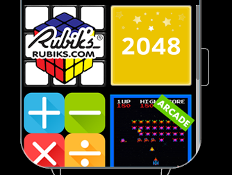

guix6.1.9版本中存在一个game的页面,关于vertical list控件,请问对应页面的跳转根据什么函数可以实现?

 楼主| 发表于 2022-9-5 18:03:31 | 显示全部楼层
eric2013 发表于 2022-9-3 10:13
近期,还没有想好怎么录制效果好。
/* This is a small demo of the high-performance GUIX graphics framework. */
#include "demo_guix_smart_watch.h"
#define GAME_LIST_VISIBLE_ROWS 2
GX_RESOURCE_ID game_ids[] = {
    GX_PIXELMAP_ID_GAME_ONE,
    GX_PIXELMAP_ID_GAME_TWO,
    GX_PIXELMAP_ID_GAME_THREE,
    GX_PIXELMAP_ID_GAME_FOUR,
/* GAME list row structure. */
typedef struct GAME_LIST_ROW_STRUCT {
    GX_WIDGET          widget;
    GX_PIXELMAP_BUTTON game_1;
    GX_PIXELMAP_BUTTON game_2;
} GAME_LIST_ROW;
GAME_LIST_ROW game_list_row_memory[GAME_LIST_VISIBLE_ROWS + 1];
VOID game_list_button_draw(GX_PIXELMAP_BUTTON *button)
    GX_PIXELMAP *map;
    gx_pixelmap_button_draw(button);
    if (button->gx_widget_style & GX_STYLE_BUTTON_PUSHED){
        gx_context_pixelmap_get(GX_PIXELMAP_ID_HALF_RANSPARENT_COVER, &map);
        gx_canvas_pixelmap_draw(button->gx_widget_size.gx_rectangle_left,
        button->gx_widget_size.gx_rectangle_top, map);
VOID game_list_row_create(GX_VERTICAL_LIST *list, GX_WIDGET *widget, INT index)
    GX_RECTANGLE childsize;
    GAME_LIST_ROW *row = (GAME_LIST_ROW *)widget;
    GX_BOOL result;
    gx_widget_created_test(&row->widget, &result);
    if (!result){
        gx_utility_rectangle_define(&childsize, 0, 5, 256, 130);
        gx_widget_create(&row->widget, NULL, (GX_WIDGET *)list,
    GX_STYLE_TRANSPARENT, 0, &childsize);
        gx_utility_rectangle_define(&childsize, 4, 5, 126, 125);
        gx_pixelmap_button_create(&row->game_1, NULL, (GX_WIDGET *)&row->widget, GX_NULL,
    GX_NULL, GX_NULL,GX_STYLE_ENABLED, 0, &childsize);
        gx_widget_draw_set(&row->game_1, game_list_button_draw);
        gx_widget_fill_color_set(&row->game_1, GX_COLOR_ID_BLACK, GX_COLOR_ID_BLACK,
    GX_COLOR_ID_BLACK);
        gx_utility_rectangle_define(&childsize, 128, 5, 260, 125);
        gx_pixelmap_button_create(&row->game_2, NULL, (GX_WIDGET *)&row->widget,
    GX_NULL, GX_NULL, GX_NULL,GX_STYLE_ENABLED, 0, &childsize);
        gx_widget_draw_set(&row->game_2, game_list_button_draw);
        gx_widget_fill_color_set(&row->game_2, GX_COLOR_ID_BLACK, GX_COLOR_ID_BLACK,
    GX_COLOR_ID_BLACK);
    gx_pixelmap_button_pixelmap_set(&row->game_1, game_ids[index << 1], game_ids[index << 1], GX_NULL);
    gx_pixelmap_button_pixelmap_set(&row->game_2, game_ids[(index << 1) + 1], game_ids[(index << 1) + 1], GX_NULL);
VOID game_list_children_create(GX_VERTICAL_LIST *list)
{  //GAME_LIST_VISIBLE_ROWS  = 2
    INT count;
    for (count = 0; count < GAME_LIST_VISIBLE_ROWS + 1; count++){
        game_list_row_create(list, (GX_WIDGET *)&game_list_row_memory[count], count);
UINT my_control_center_event_handler(GX_WINDOW *window, GX_EVENT *event_ptr)
    switch(event_ptr->gx_event_type){
        case GX_SIGNAL(ID_CONTROL_CENTER,GX_EVENT_LIST_SELECT):
            break;
        default:
            break;
    return screen_template_event_process(window, event_ptr);
关于创建的按键如何跳转,页面的回调函数怎样更稳定的切换界面呢?
