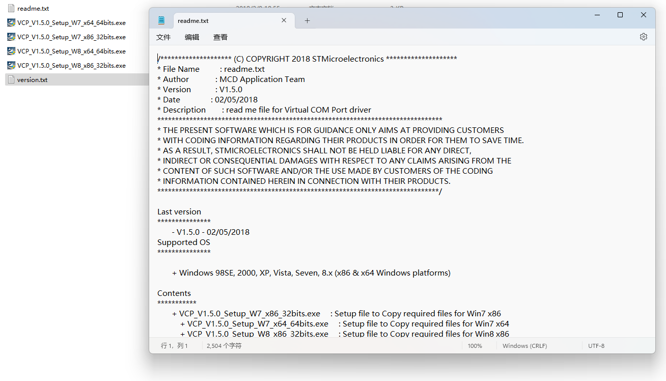

发表于 2024-7-19 15:49:07 | 显示全部楼层
那估计是那个版本的例程或USB中间件有问题。我负责的那些产品一直都用ST的标准CDC,没碰过任何一台电脑必须装ST驱动的。不过之前确实碰过某个版本的例程枚举过程有坑,导致只能用ST的驱动。ST最新版本的驱动明确说WIN10不要装。
/******************** (C) COPYRIGHT 2018 STMicroelectronics ********************
* File Name          : version.txt
* Author             : MCD Application Team
* Version            : V1.5.0
* Date               : 02/05/2018
* Description        : Version file for Virtual COM Port driver
* THE PRESENT SOFTWARE WHICH IS FOR GUIDANCE ONLY AIMS AT PROVIDING CUSTOMERS
* WITH CODING INFORMATION REGARDING THEIR PRODUCTS IN ORDER FOR THEM TO SAVE TIME.
* AS A RESULT, STMICROELECTRONICS SHALL NOT BE HELD LIABLE FOR ANY DIRECT,
* INDIRECT OR CONSEQUENTIAL DAMAGES WITH RESPECT TO ANY CLAIMS ARISING FROM THE
* CONTENT OF SUCH SOFTWARE AND/OR THE USE MADE BY CUSTOMERS OF THE CODING
* INFORMATION CONTAINED HEREIN IN CONNECTION WITH THEIR PRODUCTS.
* V1.5.0 - 02/05/2018
New Features
       + Install simplified for better user experience depending on Windows OS,
           + For Windows 10, use Microsoft inbox driver and not this package.
116008
