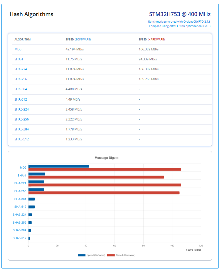

Cyclone
部分截图
https://www.oryx-embedded.com/benchmark/st/crypto-stm32h7.html
