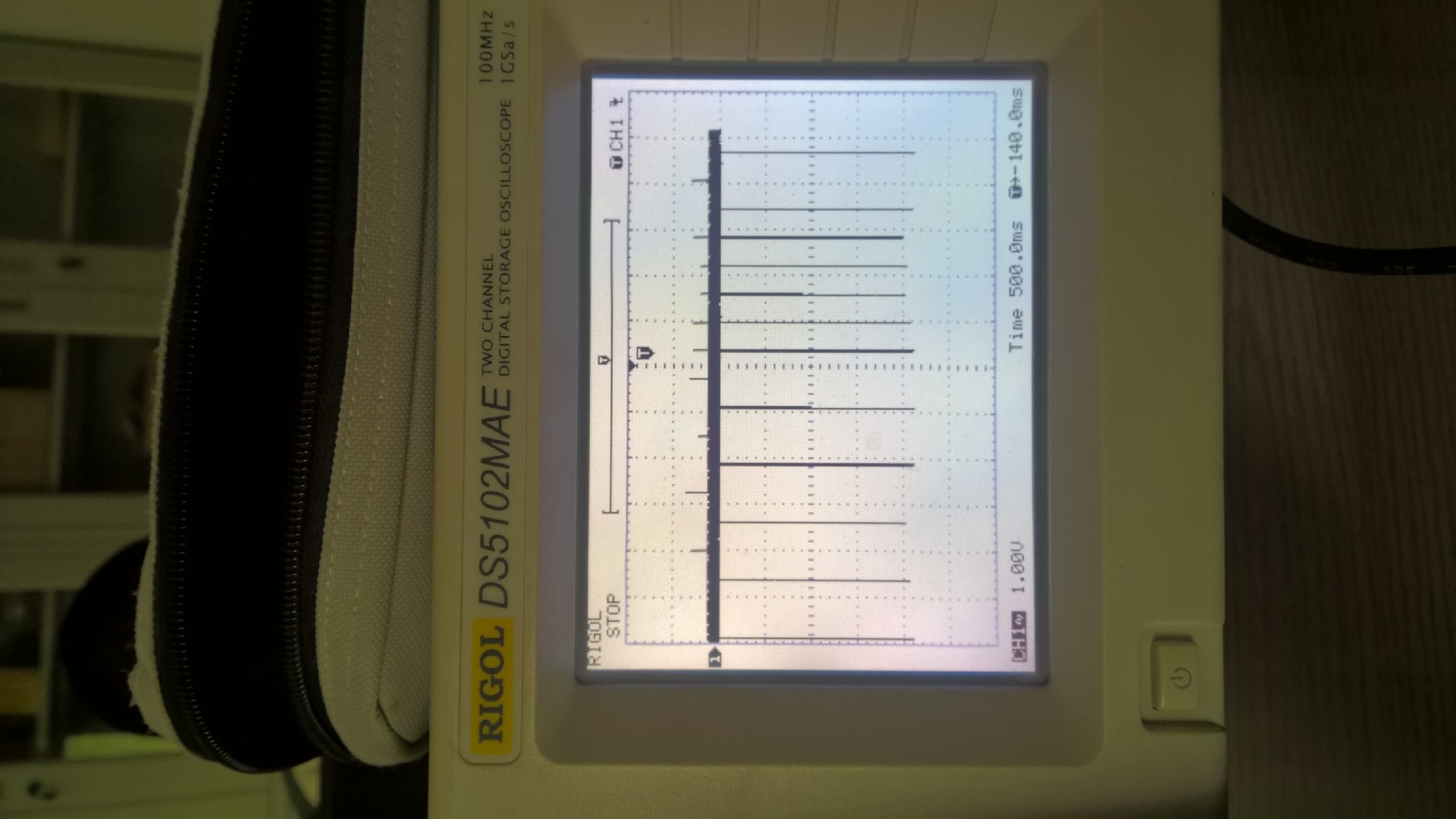

如题,本人在测试STOP模式下闹钟唤醒,发现唤醒间隙不一致,如图所示:  在非低功耗模式下,则可以获得等宽的脉冲(等间隙唤醒),希望得到大神解惑 QQ图片20170427171736.jpg

下面是代码:
int RTC_Init_User(void)
        EXTI_InitTypeDef EXTI_InitStructure;
        NVIC_InitTypeDef NVIC_InitStructure;
   // RCC_APB2PeriphClockCmd(RCC_APB2Periph_AFIO, ENABLE);
        RCC_APB1PeriphClockCmd(RCC_APB1Periph_PWR | RCC_APB1Periph_BKP, ENABLE);
        BKP_DeInit();
    //使能后备寄存器访问
    PWR_BackupAccessCmd(ENABLE);
    RCC_LSICmd(ENABLE);
        while(RCC_GetFlagStatus(RCC_FLAG_LSIRDY) == 0) {};
    RCC_RTCCLKConfig(RCC_RTCCLKSource_LSI);
    RCC_RTCCLKCmd(ENABLE);
    RTC_WaitForLastTask();
        RTC_WaitForSynchro();
    RTC_SetPrescaler(4000);
    RTC_SetCounter(0);
    RTC_SetAlarm(RTC_GetCounter()+2);  //设置闹钟时间  默认初始化为0.5秒钟后闹钟事件
    RTC_ITConfig(RTC_IT_ALR, ENABLE);
//        PWR_Cfg_User();
            //闹钟中断接到第17线外部中断
    EXTI_ClearITPendingBit(EXTI_Line17);
    EXTI_InitStructure.EXTI_Line = EXTI_Line17;
    EXTI_InitStructure.EXTI_Mode = EXTI_Mode_Interrupt;
    EXTI_InitStructure.EXTI_Trigger = EXTI_Trigger_Rising;
    EXTI_InitStructure.EXTI_LineCmd = ENABLE;
    EXTI_Init(&EXTI_InitStructure);
        NVIC_InitStructure.NVIC_IRQChannel = RTCAlarm_IRQn;//闹钟唤醒
        NVIC_InitStructure.NVIC_IRQChannelPreemptionPriority = 1;
        NVIC_InitStructure.NVIC_IRQChannelSubPriority = 1;
        NVIC_InitStructure.NVIC_IRQChannelCmd = ENABLE;
        NVIC_Init(&NVIC_InitStructure);
        return 0;
int RTC_Cfg_User(uint8_t Alarm)
      RTC_SetAlarm(RTC_GetCounter()+Alarm);  //设置闹钟时间
    return 0;
void RTCAlarm_IRQHandler()
    uint32_t iTemp=0;
  if (RTC_GetITStatus(RTC_IT_ALR) != RESET)
            RTC_ClearITPendingBit(RTC_IT_ALR);
            if(PWR_GetFlagStatus(PWR_FLAG_WU) != RESET)
                PWR_ClearFlag(PWR_FLAG_WU); // 清除唤醒标志
            GPIO_ToggleBits(GPIO_Pin_13,GPIOC);
            RTC_SetCounter(0);
            iTemp=RTC_GetCounter();
            RTC_SetAlarm((uint32_t)(iTemp+2));  //设置闹钟时间  默认初始化为0.5秒钟后闹钟事件

RTX系统的低功耗tickless模式里面有折腾过一次,可以参看:http://www.armbbs.cn/forum.php?mod=viewthread&tid=14837
