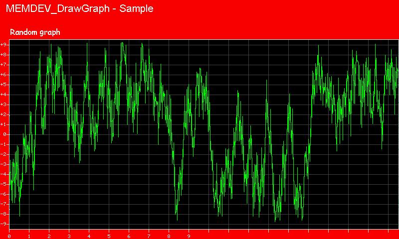

发表于 2014-5-20 18:41:04 | 显示全部楼层
You can run this demo:
  1. #include "GUI.h"
  2. #include "DIALOG.h"
  3. #include "WM.h"

  24. /*******************************************************************
  25. *
  26. *       defines
  27. *
  28. ********************************************************************
  29. */
  30. #define YSIZE   (LCD_YSIZE - 100)
  31. #define DEG2RAD (3.1415926f / 180)
  32. #if LCD_BITSPERPIXEL == 1
  33.   #define COLOR_GRAPH0 GUI_WHITE
  34.   #define COLOR_GRAPH1 GUI_WHITE
  35. #else
  36.   #define COLOR_GRAPH0 GUI_GREEN
  37.   #define COLOR_GRAPH1 GUI_YELLOW
  38. #endif
  39. /*******************************************************************
  40. *
  41. *      structure containing information for drawing routine
  42. */
  43. typedef struct {
  44.   I16 *aY;
  45. } PARAM;
  46. /*******************************************************************
  47. *
  48. *       static code
  49. *
  50. ********************************************************************
  51. */
  52. /*******************************************************************
  53. *
  54. *       _Draw
  55.
  56.   Draws the graph area
  57. */
  58. static void _Draw(void * p) {
  59.   int i;
  60.   PARAM * pParam = (PARAM *)p;
  61.   GUI_SetBkColor(GUI_BLACK);
  62.   GUI_SetColor(GUI_DARKGRAY);
  63.   GUI_ClearRect(19, (LCD_YSIZE - 20) - YSIZE, (LCD_XSIZE - 2), (LCD_YSIZE - 21));
  64.   for (i = 0; i < (YSIZE / 2); i += 20) {
  65.     GUI_DrawHLine((LCD_YSIZE - 20) - (YSIZE / 2) + i, 19, (LCD_XSIZE - 2));
  66.     if (i) {
  67.       GUI_DrawHLine((LCD_YSIZE - 20) - (YSIZE / 2) - i, 19, (LCD_XSIZE - 2));
  68.     }
  69.   }
  70.   for (i = 40; i < (LCD_XSIZE - 20); i += 40) {
  71.     GUI_DrawVLine(18 + i, (LCD_YSIZE - 20) - YSIZE, (LCD_YSIZE - 21));
  72.   }
  73.   GUI_SetColor(COLOR_GRAPH0);
  74.   /* Y-values of the graph, Number of Y-values, 起始的X,Y点坐标 */
  75.   GUI_DrawGraph(pParam->aY, (LCD_XSIZE - 20), 19, (LCD_YSIZE - 20) - YSIZE);
  76. }

  124. /*******************************************************************
  125. *
  126. *       _GetRandomData
  127. */
  128. static void _GetRandomData(I16 * paY, int Time, int n) {
  129.   int aDiff, i;
  130.   if (Time > 5000)
  131.     Time -= 5000;
  132.   if (Time > 2500)
  133.     Time = 5000 - Time;
  134.   Time /= 200;
  135.   aDiff = Time * Time + 1;
  136.   for (i = 0; i < n; i++) {
  137.     if (!i) {
  138.       paY[i] = rand() % YSIZE;
  139.     } else {
  140.       I16 yNew;
  141.       int yD = aDiff - (rand() % aDiff);
  142.       if (rand() & 1) {
  143.         yNew = paY[i-1] + yD;
  144.       } else {
  145.         yNew = paY[i-1] - yD;
  146.       }
  147.       if (yNew > YSIZE) {

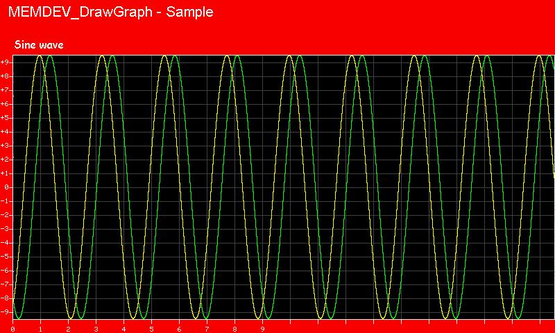

  208. /*******************************************************************
  209. *
  210. *       _DemoSineWave
  211. */
  212. static void _DemoSineWave(void) {
  213.   PARAM Param;
  214.   I16 * pStart;
  215.   int t0, Cnt = 0;
  216.   /* 矩形框大小 */
  217.   GUI_RECT Rect = {19, (LCD_YSIZE - 20) - YSIZE, (LCD_XSIZE - 2), (LCD_YSIZE - 21)};
  218.   /* 申请动态内存空间 */
  219.   GUI_HMEM hMem = GUI_ALLOC_AllocZero((LCD_XSIZE + 90) * sizeof(I16));
  220.   GUI_SetColor(GUI_WHITE);
  221.   GUI_SetBkColor(GUI_RED);
  222.   GUI_ClearRect(0, 55, LCD_XSIZE, 75);
  223.   GUI_SetFont(&GUI_FontComic18B_1);
  224.   GUI_DispStringAt("Sine wave", 20, 55);
  225.   GUI_Lock();
  226.   /* 将句柄转化成指针 */
  227.   pStart = GUI_ALLOC_h2p(hMem);
  228.   GUI_Unlock();
  229.   /* 得到正弦波数据 */
  230.   _GetSineData(pStart, (LCD_XSIZE + 90));
  231.   GUI_SetFont(&GUI_Font6x8);
  232.
  233.
  234.   t0 = GUI_GetTime();
  235.   while((GUI_GetTime() - t0) < 10000) {
  236.     int t1, tDiff2;
  237.
  238.     /* 90个数值是一个正弦波的周期 到了一个周期之后,自动的转化到首字节 */
  239.     if (Cnt++ % 90) {
  240.       Param.aY++;
  241.     } else {
  242.         Param.aY = pStart;
  243.     }
  244.
  245.     /* 采用分片存储空间绘制 */
  246.     /* 矩形框,回调函数,回调函数的参数 ,0或存储设备的分段数量, O或者GUI_MEMDEV_HASTRANS*/
  247.     t1 = GUI_GetTime();
  248.     GUI_MEMDEV_Draw(&Rect, _Draw2, &Param, 0, 0);
  249.    /* 绘图的运行时间是否超过100MS,没有的话,执行延时 */
  250.     tDiff2 = GUI_GetTime() - t1;
  251.     if (tDiff2 < 100) {
  252.       GUI_Delay(100 - tDiff2);
  253.     }
  254.   }
  255.   /* 释放申请的内存空间 */
  256.   GUI_ALLOC_Free(hMem);
