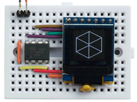

地址来源
效果:
旋转部分的代码,详情需要大家看上面的帖子地址:
  1. void RotatingCube () {
  2.   const int Delta = 9; // Approximation to 1 degree in radians * 2^9
  3.   xOrigin = 32; yOrigin = 24;
  4.   int x = 0, y = 22<<9;
  5.   for (;;) {
  6.     ClearBuffer();
  7.     int x9 = x>>9, y9 = y>>9, x10 = x>>10, y10 = y>>10;
  8.     // Top
  9.     MoveTo(x9, y10 + 12); DrawTo(y9, -x10 + 12);
  10.     DrawTo(-x9, -y10 + 12); DrawTo(-y9, x10 + 12);
  11.     DrawTo(x9, y10 + 12); DrawTo(x9, y10 - 12);
  12.     // Bottom
  13.     DrawTo(y9, -x10 - 12); DrawTo(-x9, -y10 - 12);
  14.     DrawTo(-y9, x10 - 12); DrawTo(x9, y10 - 12);
  15.     // Sides
  16.     MoveTo(y9, -x10 + 12); DrawTo(y9, -x10 - 12);
  17.     MoveTo(-x9, -y10 + 12); DrawTo(-x9, -y10 - 12);
  18.     MoveTo(-y9, x10 + 12); DrawTo(-y9, x10 - 12);
  19.     // Rotate cube
  20.     x = x + (y9 * Delta);
  21.     y = y - ((x>>9) * Delta);
  22.     DisplayBuffer();
  23.   }
  24. }

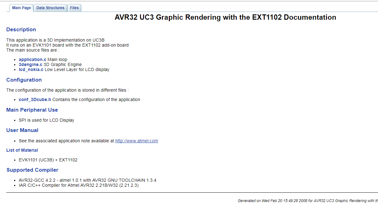

 楼主| 发表于 2018-6-9 01:06:16 | 显示全部楼层
3D_CUBE-1.0.0-es.rar (1.08 MB, 下载次数: 88)
