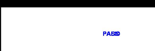

这么调用,字符就会叠加显示
TEXT2 =TEXT_CreateAsChild(350,80, 157,59, WM_HBKWIN, GUI_ID_TEXT0,WM_CF_SHOW,0,0);
TEXT_SetTextColor(TEXT2,GUI_BLUE);
TEXT_SetFont(TEXT2, GUI_FONT_24B_ASCII);
TEXT_SetText(TEXT2,"PASS   ");TEXT_SetText(TEXT2,"FALID  ");

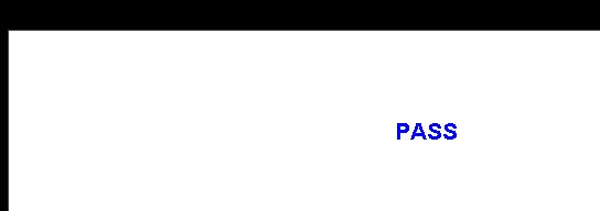

添加上背景色设置API函数TEXT_SetBkColor就正常了,或者不调用前景色设置函数,仅调用背景色API也是可以的:
TEXT_SetBkColor(TEXT2, GUI_WHITE);
