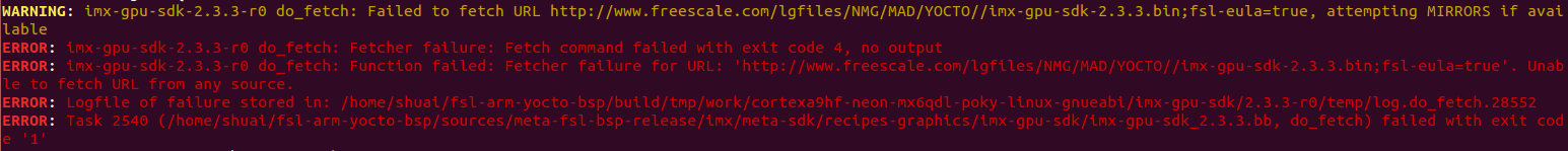

使用FSL Community BSP编译imax6q的包含Qt5开发环境,总是出现Fetcher failure,系统及错误信息如下所示
但是将网址拷贝到浏览器中是可以下载的,为什么yocto就是下载失败呢?有人遇到过这个问题吗?该怎么解决啊?谢谢

freescale官网已经挂了,地址需要重新解析到http://www.nxp.com/lgfiles/NMG/MAD/YOCTO/imx-gpu-sdk-2.3.3.bin
用浏览器能下载的原因应该是域名被重定位了;脚本里直接fetch是直连,没有经过解析,所以才会失败。修改脚本里的网址为以上地址就好了。

谢谢指点,不过换了地址以后还是有问题
ERROR: imx-gpu-sdk-2.3.3-r0 do_fetch: Fetcher failure: Fetch command failed with exit code 4, no output
ERROR: imx-gpu-sdk-2.3.3-r0 do_fetch: Function failed: Fetcher failure for URL: 'http://www.nxp.com/lgfiles/NMG/MAD/YOCTO/imx-gpu-sdk-2.3.3.bin;fsl-eula=true'. Unable to fetch URL from any source.
ERROR: Logfile of failure stored in: /home/shuai/fsl-arm-yocto-bsp/build/tmp/work/cortexa9hf-neon-mx6qdl-poky-linux-gnueabi/imx-gpu-sdk/2.3.3-r0/temp/log.do_fetch.18615
ERROR: Task 2540 (/home/shuai/fsl-arm-yocto-bsp/sources/meta-fsl-bsp-release/imx/meta-sdk/recipes-graphics/imx-gpu-sdk/imx-gpu-sdk_2.3.3.bb, do_fetch) failed with exit code '1'
