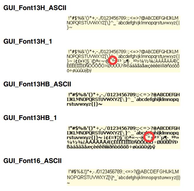

这个要指定非ASCII字体才行吧,大佬

  1. void display_latitude(struct minmea_position *latitude, int x0 , int y0)
  2. {
  3.
  4.         char degree_buf[3],minute_buf[7];
  5.         rt_memset(latitude_buf,0,12);
  6.         rt_sprintf(degree_buf,"%d",latitude->degrees);
  7.         sprintf(minute_buf,"%5.3f",latitude->minutes);
  8.
  9.         rt_strncpy(latitude_buf,degree_buf,2);
  10.         strcat(latitude_buf,"\xb0");
  11.         strcat(latitude_buf,minute_buf);
  12.         strcat(latitude_buf," ");
  13.         strncat(latitude_buf,&latitude->direction,1);
  14.         GUI_SetFont(&GUI_Font16B_1);
  15.         GUI_DispStringAt(latitude_buf, x0, y0);
  16. }
感谢各位解答,最简单的做法是上边那种。想要好看的,可以生成抗锯齿字体吧。
