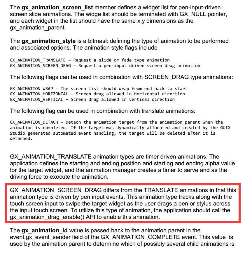

[ThreadX全家桶] ThreadX GUIX窗口滑动通过函数gx_animation_drag_enable来实现
115804
发表于 2020-12-16 09:24:13 | 显示全部楼层 |阅读模式
代码:
  1. /******************************************************************************************/
  2. /* Start screen slide animation for specified window.                                     */
  3. /******************************************************************************************/
  4. static VOID slide_animation_start(GX_WINDOW *window)
  5. {
  6.     GX_ANIMATION_INFO slide_animation_info;
  7.     SCREEN_INFO *info = screen_info_get(window->gx_widget_parent);
  8.     if (info)
  9.     {
  10.         if (!window->gx_widget_first_child)
  11.         {
  12.             gx_widget_attach((GX_WIDGET *)window, info->window_list[0]);
  13.         }
  14.         memset(&slide_animation_info, 0, sizeof(GX_ANIMATION_INFO));
  15.         slide_animation_info.gx_animation_parent = (GX_WIDGET *)window;
  16.         slide_animation_info.gx_animation_style = GX_ANIMATION_SCREEN_DRAG | GX_ANIMATION_HORIZONTAL | GX_ANIMATION_WRAP | GX_ANIMATION_SINE_EASE_OUT;
  17.         slide_animation_info.gx_animation_id = ANIMATION_ID_DRAG_SLIDE;
  18.         slide_animation_info.gx_animation_frame_interval = 2;
  19.         slide_animation_info.gx_animation_steps = 15;
  20.         slide_animation_info.gx_animation_slide_screen_list = info->window_list;
  21.         gx_animation_drag_enable(&slide_animation, (GX_WIDGET *)window, &slide_animation_info);
  22.     }
  23. }
