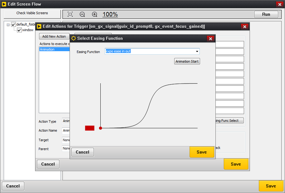

桌面图标滑动要选择一个合适的曲线效果
/* flag that can be used in combination with translate animation */
#define GX_ANIMATION_PUSH_STACK             0x4000U
#define GX_ANIMATION_DETACH                 0x8000U
#define GX_ANIMATION_EASING_FUNC_MASK       0x10f0U
#define GX_ANIMATION_BACK_EASE_IN           0x0010U
#define GX_ANIMATION_BACK_EASE_OUT          0x0020U
#define GX_ANIMATION_BACK_EASE_IN_OUT       0x0030U
#define GX_ANIMATION_BOUNCE_EASE_IN         0x0040U
#define GX_ANIMATION_BOUNCE_EASE_OUT        0x0050U
#define GX_ANIMATION_BOUNCE_EASE_IN_OUT     0x0060U
#define GX_ANIMATION_CIRC_EASE_IN           0x0070U
#define GX_ANIMATION_CIRC_EASE_OUT          0x0080U
#define GX_ANIMATION_CIRC_EASE_IN_OUT       0x0090U
#define GX_ANIMATION_CUBIC_EASE_IN          0x00a0U
#define GX_ANIMATION_CUBIC_EASE_OUT         0x00b0U
#define GX_ANIMATION_CUBIC_EASE_IN_OUT      0x00c0U
#define GX_ANIMATION_ELASTIC_EASE_IN        0x00d0U
#define GX_ANIMATION_ELASTIC_EASE_OUT       0x00e0U
#define GX_ANIMATION_ELASTIC_EASE_IN_OUT    0x00f0U
#define GX_ANIMATION_EXPO_EASE_IN           0x1000U
#define GX_ANIMATION_EXPO_EASE_OUT          0x1010U
#define GX_ANIMATION_EXPO_EASE_IN_OUT       0x1020U
#define GX_ANIMATION_QUAD_EASE_IN           0x1030U
#define GX_ANIMATION_QUAD_EASE_OUT          0x1040U
#define GX_ANIMATION_QUAD_EASE_IN_OUT       0x1050U
#define GX_ANIMATION_QUART_EASE_IN          0x1060U
#define GX_ANIMATION_QUART_EASE_OUT         0x1070U
#define GX_ANIMATION_QUART_EASE_IN_OUT      0x1080U
#define GX_ANIMATION_QUINT_EASE_IN          0x1090U
#define GX_ANIMATION_QUINT_EASE_OUT         0x10a0U
#define GX_ANIMATION_QUINT_EASE_IN_OUT      0x10b0U
#define GX_ANIMATION_SINE_EASE_IN           0x10c0U
#define GX_ANIMATION_SINE_EASE_OUT          0x10d0U
#define GX_ANIMATION_SINE_EASE_IN_OUT       0x10e0U
