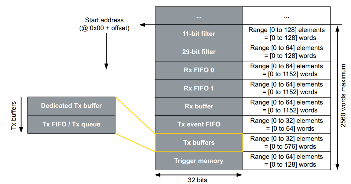

[CAN/FDCAN] CMSIS-Driver CAN FD驱动对STM32H7带的2560字RAM分配,值得借鉴
116742
发表于 2021-3-24 10:45:25 | 显示全部楼层 |阅读模式
2560字RAM区:
分配如下:
  1. *   CAN_CLOCK_TOLERANCE:       defines maximum allowed clock tolerance in 1/1024 steps
  2. *     - default value:         15  (approx. 1.5 %)
  3. *   CAN_NON_ISO_EN:            used to enable non-ISO CAN FD mode
  4. *     - default value          0 (disabled)
  5. *
  6. *   CAN1 controller configuration:
  7. *   CAN1_RX_FIFO0_ELEM_NUM:    number of receive  FIFO0 elements   (default=8,   max=64)
  8. *   CAN1_RX_FIFO1_ELEM_NUM:    number of receive  FIFO1 elements   (default=8,   max=64)
  9. *   CAN1_TX_FIFO_ELEM_NUM:     number of transmit FIFO  elements   (default=8,   max=32)
  10. *   CAN1_RX_BUF_NUM:           maximum number of receive  buffers  (default=16,  max=64)
  11. *   CAN1_TX_BUF_NUM:           maximum number of transmit buffers  (default=16,  max=32)
  12. *   CAN1_FILTER_STD_NUM:       maximum number of standard elements (default=128, max=128)
  13. *   CAN1_FILTER_EXT_NUM:       maximum number of extended elements (default=64,  max=64)
  14. *
  15. *   CAN2 controller configuration:
  16. *   CAN2_RX_FIFO0_ELEM_NUM:    number of receive  FIFO0 elements   (default=8,   max=64)
  17. *   CAN2_RX_FIFO1_ELEM_NUM:    number of receive  FIFO1 elements   (default=8,   max=64)
  18. *   CAN2_TX_FIFO_ELEM_NUM:     number of transmit FIFO  elements   (default=8,   max=32)
  19. *   CAN2_RX_BUF_NUM:           maximum number of receive  buffers  (default=16,  max=64)
  20. *   CAN2_TX_BUF_NUM:           maximum number of transmit buffers  (default=16,  max=32)
  21. *   CAN2_FILTER_STD_NUM:       maximum number of standard elements (default=128, max=128)
  22. *   CAN2_FILTER_EXT_NUM:       maximum number of extended elements (default=64,  max=64)
通过各种条件编译设置,防止用户使用时配置错误:

  104. #if    (CAN2_FILTER_STD_NUM > 128U)
  105. #error  Standard Filter Elements defined for CAN2, maximum number of Standard Filter Elements is 128 !!!
  106. #endif
  107. #ifndef CAN2_FILTER_EXT_NUM
  108. #define CAN2_FILTER_EXT_NUM             (64U)
  109. #endif
  110. #if    (CAN2_FILTER_EXT_NUM > 64U)
  111. #error  Extended Filter Elements defined for CAN2, maximum number of Extended Filter Elements is 64 !!!
  112. #endif
  113. #define CAN2_RX_FIFO_EN                ((CAN2_RX_FIFO0_ELEM_NUM != 0U) || (CAN2_RX_FIFO1_ELEM_NUM != 0U))
  114. #define CAN2_RX_BUF_EN                  (CAN2_RX_BUF_NUM        != 0U)
  115. #define CAN2_TX_FIFO_EN                 (CAN2_TX_FIFO_ELEM_NUM  != 0U)
