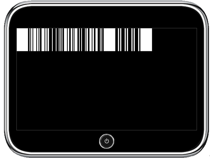

代码:
  1. #include "GUI.h"
  2. /*********************************************************************
  3. *
  4. *       MainTask
  5. */
  6. void MainTask(void) {
  7.   int i;
  8.   /* 初始化emWin */
  9.   GUI_Init();
  10.   /* 绘制条形码*/
  11.   GUI_SetColor(GUI_BLACK);
  12. GUI_SetBkColor(GUI_WHITE);
  13. GUI_BARCODE_Draw(0, 0, 3, 60, GUI_BARCODE_ITF, "123456789");
  14. GUI_BARCODE_Draw(0, 0, 2, 60, GUI_BARCODE_128, "armfly");
  15.   while (1)
  16.   {
  17.           GUI_Delay(10);
  18.   }
  19. }
效果:
