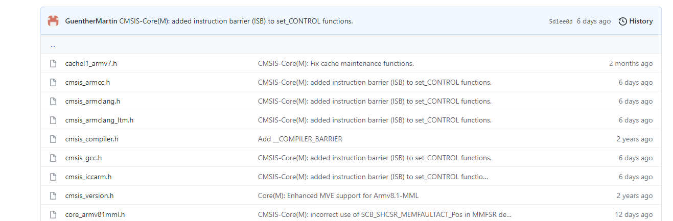

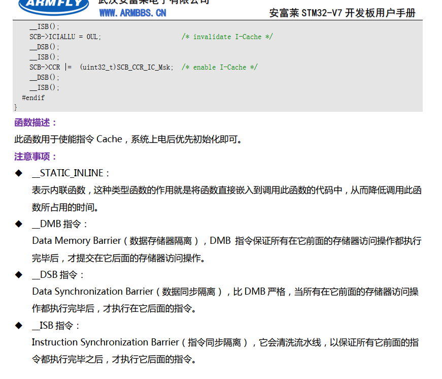

新版CMSIS软件包的函数__set_CONTROL内部将全部加入 __ISB();
115667
发表于 2021-6-22 08:41:21 | 显示全部楼层 |阅读模式
https://github.com/ARM-software/ ... /CMSIS/Core/Include
  1. /**
  2.   \brief   Set Control Register
  3.   \details Writes the given value to the Control Register.
  4.   \param [in]    control  Control Register value to set
  5. */
  6. __STATIC_INLINE void __set_CONTROL(uint32_t control)
  7. {
  8.   register uint32_t __regControl         __ASM("control");
  9.   __regControl = control;
  10.   __ISB();
  11. }
