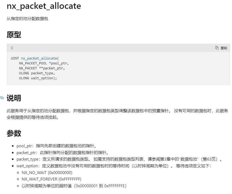

这个函数可以申请各种类似数据包:
比如申请TCP Packet
  1. /* Allocate a new TCP packet from the previously created packet pool
  2.    and suspend for a maximum of 5 timer ticks if the pool is
  3.    empty. */
  4. status = nx_packet_allocate(&pool_0, &packet_ptr,
  5.                             NX_TCP_PACKET, 5);
如果我们定义一个效果是一样的
NX_TCP_SOCKET TCPSocket
