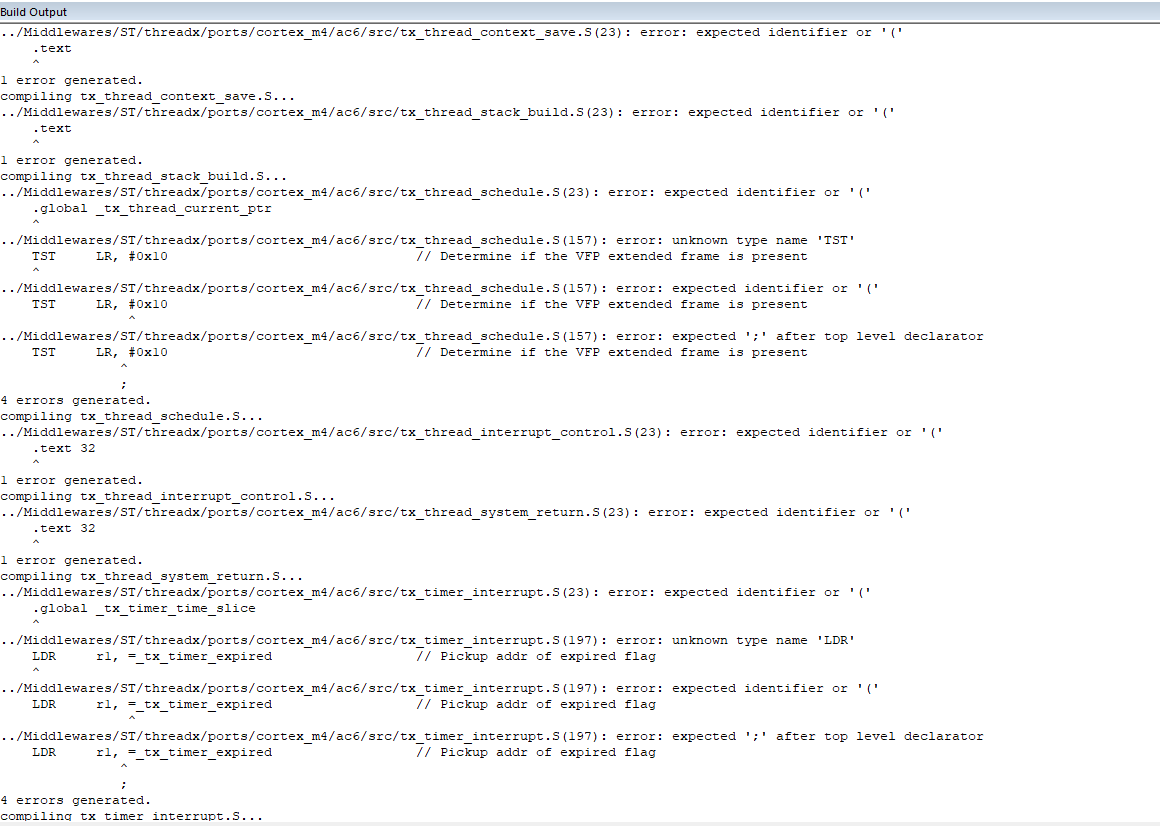

使用cubemx生成的stm32f439的工程.S的汇编文件编译失败。问题如下:Build started: Project: touchgfx_templete
*** Using Compiler 'V6.14.1', folder: 'd:\d\Keil_v5\ARM\ARMCLANG\Bin'
Build target 'touchgfx_templete'
../Middlewares/ST/threadx/ports/cortex_m4/ac6/src/tx_thread_context_restore.S(26): error: expected identifier or '('
    .text
1 error generated.
compiling tx_thread_context_restore.S...
../Middlewares/ST/threadx/ports/cortex_m4/ac6/src/tx_thread_context_save.S(23): error: expected identifier or '('
    .text
1 error generated.
compiling tx_thread_context_save.S...
../Middlewares/ST/threadx/ports/cortex_m4/ac6/src/tx_thread_stack_build.S(23): error: expected identifier or '('
    .text
1 error generated.
compiling tx_thread_stack_build.S...
../Middlewares/ST/threadx/ports/cortex_m4/ac6/src/tx_thread_schedule.S(23): error: expected identifier or '('
    .global _tx_thread_current_ptr
../Middlewares/ST/threadx/ports/cortex_m4/ac6/src/tx_thread_schedule.S(157): error: unknown type name 'TST'
    TST     LR, #0x10                               // Determine if the VFP extended frame is present
../Middlewares/ST/threadx/ports/cortex_m4/ac6/src/tx_thread_schedule.S(157): error: expected identifier or '('
../Middlewares/ST/threadx/ports/cortex_m4/ac6/src/tx_thread_schedule.S(157): error: expected ';' after top level declarator
4 errors generated.
compiling tx_thread_schedule.S...
../Middlewares/ST/threadx/ports/cortex_m4/ac6/src/tx_thread_interrupt_control.S(23): error: expected identifier or '('
    .text 32
1 error generated.
compiling tx_thread_interrupt_control.S...
../Middlewares/ST/threadx/ports/cortex_m4/ac6/src/tx_thread_system_return.S(23): error: expected identifier or '('
    .text 32
1 error generated.
compiling tx_thread_system_return.S...
../Middlewares/ST/threadx/ports/cortex_m4/ac6/src/tx_timer_interrupt.S(23): error: expected identifier or '('
    .global _tx_timer_time_slice
../Middlewares/ST/threadx/ports/cortex_m4/ac6/src/tx_timer_interrupt.S(197): error: unknown type name 'LDR'
    LDR     r1, =_tx_timer_expired                  // Pickup addr of expired flag
../Middlewares/ST/threadx/ports/cortex_m4/ac6/src/tx_timer_interrupt.S(197): error: expected identifier or '('
../Middlewares/ST/threadx/ports/cortex_m4/ac6/src/tx_timer_interrupt.S(197): error: expected ';' after top level declarator
4 errors generated.
compiling tx_timer_interrupt.S...

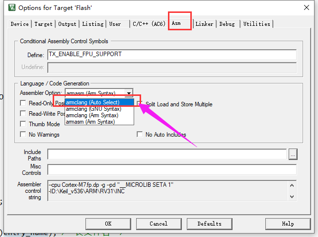

 楼主| 发表于 2022-4-14 09:59:07 | 显示全部楼层
重新升级了一下cubemx,重新编译,还是有问题,但是错误和原来的不一样了,如下
assembling tx_thread_stack_build.S...
..\Middlewares\ST\threadx\ports\cortex_m4\ac6\src\tx_thread_stack_build.S(23): error: A1137E: Unexpected characters at end of line
..\Middlewares\ST\threadx\ports\cortex_m4\ac6\src\tx_thread_stack_build.S(24): error: A1137E: Unexpected characters at end of line

发表于 2022-4-14 10:05:27 | 显示全部楼层
使用AC6的话,注意使能这个选项。
40
79
79
 楼主| 发表于 2022-4-14 12:01:06 | 显示全部楼层
eric2013 发表于 2022-4-14 10:05
使用AC6的话,注意使能这个选项。
刚才也发现了这个设置了,谢谢
问题解决
