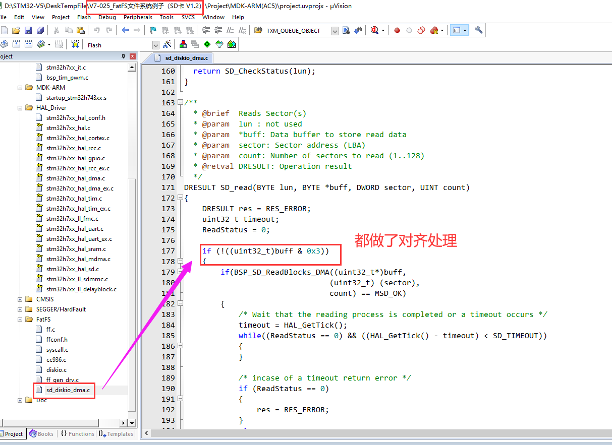

多谢硬汉哥, 原工程比较复杂。 我目前移植您的V7例子27在我的硬件上, 发现功能正常,中断能够触发。 可是 ...
这个帖子里面的fatfs,flashfs,filex都是做了对齐处理的。
系统的谈下STM32H7的SD卡驱动兼容性问题,现在兼容性很强,主流厂家16GB以上容量全部通过(2022-03-15)

115728
发表于 2022-4-24 12:41:12 | 显示全部楼层
szjdb 发表于 2022-4-24 12:33
多谢硬汉哥! 我再找找看看为何 HAL库 SD卡的运行不起来。 其他模块用HAL库没发现问题。
我下的就是您提 ...
[C] 纯文本查看 复制代码
  * @brief  Reads Sector(s)
  * @param  lun : not used
  * @param  *buff: Data buffer to store read data
  * @param  sector: Sector address (LBA)
  * @param  count: Number of sectors to read (1..128)
  * @retval DRESULT: Operation result
DRESULT SD_read(BYTE lun, BYTE *buff, DWORD sector, UINT count)
    DRESULT res = RES_ERROR;
    uint32_t timeout;
    ReadStatus = 0;
    if (!((uint32_t)buff & 0x3))
        if(BSP_SD_ReadBlocks_DMA((uint32_t*)buff,
                                (uint32_t) (sector),
                                count) == MSD_OK)
            /* Wait that the reading process is completed or a timeout occurs */
            timeout = HAL_GetTick();
            while((ReadStatus == 0) && ((HAL_GetTick() - timeout) < SD_TIMEOUT))
            /* incase of a timeout return error */
            if (ReadStatus == 0)
                res = RES_ERROR;
            else
                ReadStatus = 0;
                while((HAL_GetTick() - timeout) < SD_TIMEOUT)
                    if (BSP_SD_GetCardState() == SD_TRANSFER_OK)
                        res = RES_OK;
                        #if (ENABLE_SD_DMA_CACHE_MAINTENANCE_READ == 1)
                           SCB_CleanInvalidateDCache();
                        #endif
                        break;
    else
        uint8_t ret;
        int i;
        for (i = 0; i < count; i++)
            ret = BSP_SD_ReadBlocks_DMA((uint32_t*)scratch, (uint32_t)sector++, 1);
            if(ret == MSD_OK)
                    break;
                else
                    ReadStatus = 0;
                            #endif
                            memcpy(buff, scratch, BLOCKSIZE);
                            buff += BLOCKSIZE;
                            break;
            else
                break;
        if ((i == count) && (ret == MSD_OK))
           res = RES_OK;
    return res;
