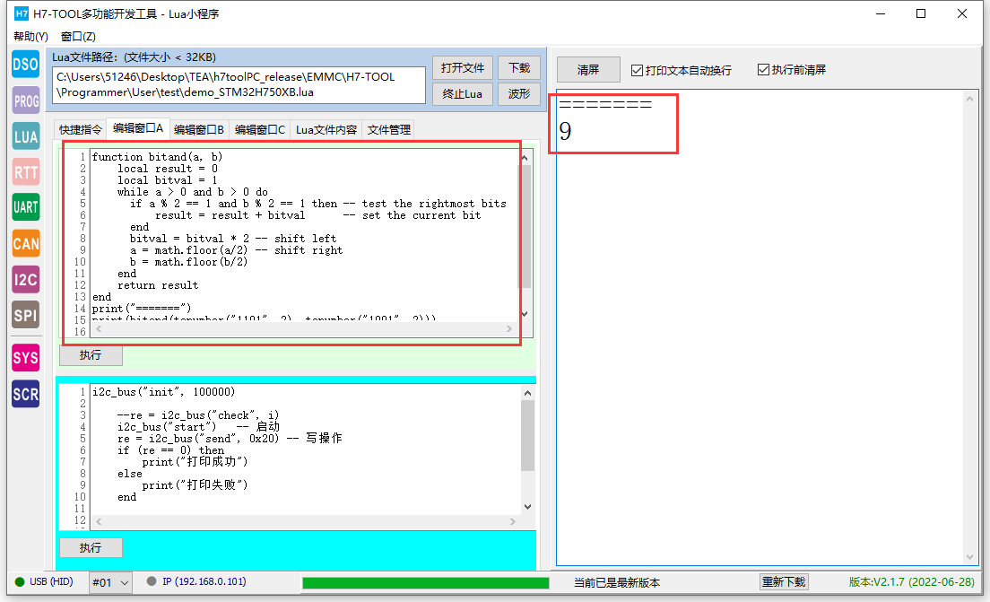

bit manipulation - "Bitwise AND" in Lua - Stack Overflow
[Lua] 纯文本查看 复制代码
function bitand(a, b)
    local result = 0
    local bitval = 1
    while a > 0 and b > 0 do
      if a % 2 == 1 and b % 2 == 1 then -- test the rightmost bits
          result = result + bitval      -- set the current bit
      end
      bitval = bitval * 2 -- shift left
      a = math.floor(a/2) -- shift right
      b = math.floor(b/2)
    end
    return result
end
print("=======")
print(bitand(tonumber("1101", 2), tonumber("1001", 2)))

Lua 5.3 已经直接支持位操作了。
print(tonumber("1101", 2)  & tonumber("1001", 2))
--        &        按位与
--        |        按位或
--        ~        按位异或
--        >>        右移

对,我们的是5.3,已经支持了,饶了个大远,
