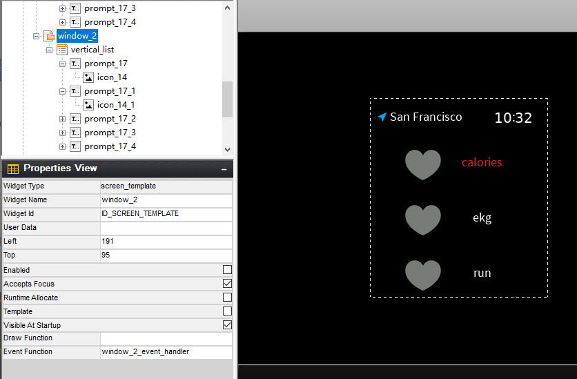

如附件视频所示,诸位有无更好的办法或者看出问题所在,初学,懂得不多;
1、ui如下
2、代码如下
UINT window_2_event_handler(GX_WINDOW *window, GX_EVENT *event_ptr)
    switch(event_ptr->gx_event_type){
    case GX_SIGNAL(ID_VERTICAL_LIST, GX_EVENT_LIST_SELECT):
            gx_vertical_list_selected_index_get(&window_2.window_2_vertical_list
            ,&selected_patient_index);
            break;
        default:
            break;
    return screen_template_event_process(window, event_ptr);
VOID ToggleScreen(GX_WIDGET *new_win, GX_WIDGET *old_win)
    gx_widget_hide(old_win);
    if (!new_win->gx_widget_parent){
        gx_widget_attach((GX_WIDGET *)&page_2_container_screen, new_win);
    }else{
        gx_widget_show(new_win);
/* Override the default event processing of "screen_template" to handle signals from my   */
/* child widgets.                                                                         */
UINT screen_template_event_process(GX_WINDOW *window, GX_EVENT* event_ptr)
    ULONG ret;
    ret = event_ptr->gx_event_payload.gx_event_ulongdata;
    switch (event_ptr->gx_event_type)
        case GX_EVENT_SHOW:
            /* Update title bar clock.  */
            update_title_clock((SCREEN_TEMPLATE_CONTROL_BLOCK *)window);
            /* Start a timer to update title bar clock.  */
            gx_system_timer_start(window, SCREEN_CLOCK_TIMER_ID, GX_TICKS_SECOND, GX_TICKS_SECOND);
            return gx_window_event_process(window, event_ptr);
        case GX_EVENT_HIDE:
            /* Stop clock update timer.  */
            gx_system_timer_stop(window, SCREEN_CLOCK_TIMER_ID);
        case GX_EVENT_TIMER:
            if (event_ptr->gx_event_payload.gx_event_timer_id == SCREEN_CLOCK_TIMER_ID){
            break;
            if(ret == 0){
                ToggleScreen((GX_WIDGET *) &calories_screen,(GX_WIDGET *)window);
            else if(ret == 1){
                ToggleScreen((GX_WIDGET *) &ekg_screen,(GX_WIDGET *)window);
            else if(ret == 2){
                ToggleScreen((GX_WIDGET *) &run_screen,(GX_WIDGET *)window);
            else if(ret == 3){
                ToggleScreen((GX_WIDGET *) &stand_screen,(GX_WIDGET *)window);
            else if(ret == 4){
                ToggleScreen((GX_WIDGET *) &yoga_screen,(GX_WIDGET *)window);
            break;
        default:
    return 0;
GUIX 2022-08-12 13-22-35.mp4
9.34 MB, 下载次数: 2
115863
发表于 2022-8-13 11:16:12 | 显示全部楼层
你这个是背景区没有重绘吧

发表于 2022-8-16 00:44:11 | 显示全部楼层
gck 发表于 2022-8-15 09:53
不太懂,请教在哪块添加函数合适些?
就是你绘制你这个界面的时候,是绘制的整个显示区吗,从你的视频效果来看,你的两个边界是没有绘制的。

 楼主| 发表于 2022-8-16 10:51:55 | 显示全部楼层
参照官方例子中demo_guix_vertical_list以及demo_guix_medical;绘制的是页面的整个显示区。
115863
发表于 2022-8-17 09:38:46 | 显示全部楼层
左右两边应该是没有绘制到,你发的那个视频效果确实是有残影。

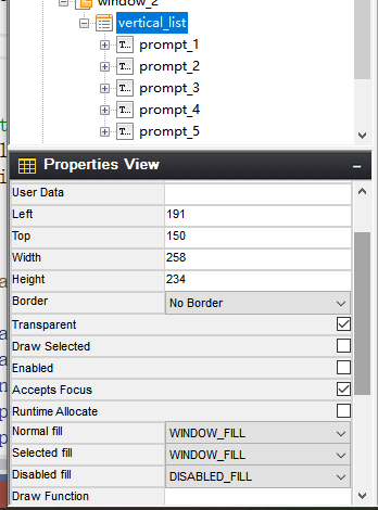

 楼主| 发表于 2022-8-17 11:23:27 | 显示全部楼层
官方大多例子中关于vertical_list没有通过guix studio直接创建控件的行情况,而是通过vertical_list的回调函数来实现行结构的;guix sudio直接在页面下创建vertical_list,只是通过该页面的回调函数拿到滑动选中的数值,是不是vertical_list回调函数是必须创建的,是否这块就是问题原因所在?
楼主什么时候有时间能够更新一下这方面内容?即使官方给出的例子,vs2019上很快模拟;仍然存在一些可能不知道的设计思维,控件组合、各参数情况、回调函数等等,都是互相联系的。
62
181
367
367
 楼主| 发表于 2022-8-20 17:47:33 | 显示全部楼层
问题已经解决,vertical_list设计中参数设置不正确导致的,另外如果有更好的方式,更人性化的设计思路,欢迎在下方留言指导。
