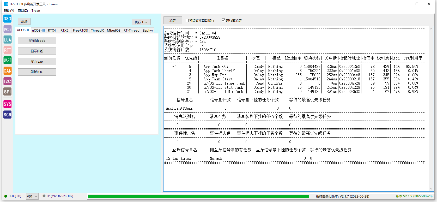

耽误了一周的时候整理截图功能,截图功能初步成型了,剩下就是优化速度和稳定性。
剩下集中精力整Trace,争取早点发布了,uCOS-III的已经添加差不多了,下一个就是ThreadX,这两天就研究源码
Trace功能需要把ThreadX的各种链表关系捋顺。

/* Define the preempt map active bit map that specifies which of the previously
   defined preempt maps have something set. This is only necessary if more than
   32 priorities are supported.  */
#if TX_MAX_PRIORITIES > 32
THREAD_DECLARE  ULONG           _tx_thread_preempted_map_active;
#endif
#endif
/* Define the variable that holds the highest priority group ready for
   execution.  It is important to note that this is not necessarily the same
   as the priority of the thread pointed to by _tx_execute_thread.  */
THREAD_DECLARE  UINT            _tx_thread_highest_priority;
/* Define the array of thread pointers.  Each entry represents the threads that
   are ready at that priority group.  For example, index 10 in this array
   represents the first thread ready at priority 10.  If this entry is NULL,
   no threads are ready at that priority.  */
THREAD_DECLARE  TX_THREAD *     _tx_thread_priority_list[TX_MAX_PRIORITIES];
/* Define the global preempt disable variable.  If this is non-zero, preemption is
   disabled.  It is used internally by ThreadX to prevent preemption of a thread in
   the middle of a service that is resuming or suspending another thread.  */
THREAD_DECLARE  volatile UINT   _tx_thread_preempt_disable;
/* Define the global function pointer for mutex cleanup on thread completion or
   termination. This pointer is setup during mutex initialization.  */
THREAD_DECLARE  VOID            (*_tx_thread_mutex_release)(TX_THREAD *thread_ptr);
/* Define the global build options variable.  This contains a bit map representing
   how the ThreadX library was built. The following are the bit field definitions:
                    Bit(s)                   Meaning
                    31                  TX_NOT_INTERRUPTABLE defined
                    30                  TX_INLINE_THREAD_RESUME_SUSPEND define
                    29-24               Priority groups 1  -> 32 priorities
                                                        2  -> 64 priorities
                                                        3  -> 96 priorities
                                                        32 -> 1024 priorities
                    23                  TX_TIMER_PROCESS_IN_ISR defined
                    22                  TX_REACTIVATE_INLINE defined
                    21                  TX_DISABLE_STACK_FILLING defined
                    20                  TX_ENABLE_STACK_CHECKING defined
                    19                  TX_DISABLE_PREEMPTION_THRESHOLD defined
                    18                  TX_DISABLE_REDUNDANT_CLEARING defined
                    17                  TX_DISABLE_NOTIFY_CALLBACKS defined
                    16                  TX_BLOCK_POOL_ENABLE_PERFORMANCE_INFO defined
                    15                  TX_BYTE_POOL_ENABLE_PERFORMANCE_INFO defined
                    14                  TX_EVENT_FLAGS_ENABLE_PERFORMANCE_INFO defined
                    13                  TX_MUTEX_ENABLE_PERFORMANCE_INFO defined
                    12                  TX_QUEUE_ENABLE_PERFORMANCE_INFO defined
                    11                  TX_SEMAPHORE_ENABLE_PERFORMANCE_INFO defined
                    10                  TX_THREAD_ENABLE_PERFORMANCE_INFO defined
                    9                   TX_TIMER_ENABLE_PERFORMANCE_INFO defined
                    8                   TX_ENABLE_EVENT_TRACE defined
                    7                   TX_ENABLE_EXECUTION_CHANGE_NOTIFY defined
                    6-0                 Port Specific   */
THREAD_DECLARE  ULONG           _tx_build_options;

添加了下,还有点问题,白天继续搞下。
ThreadX获取任务创建列表使用变量_tx_thread_created_ptr即可,Trace要跟踪这个变量。
116110
 楼主| 发表于 2022-9-27 05:44:48 | 显示全部楼层
能正常检索了,还要继续改进。
