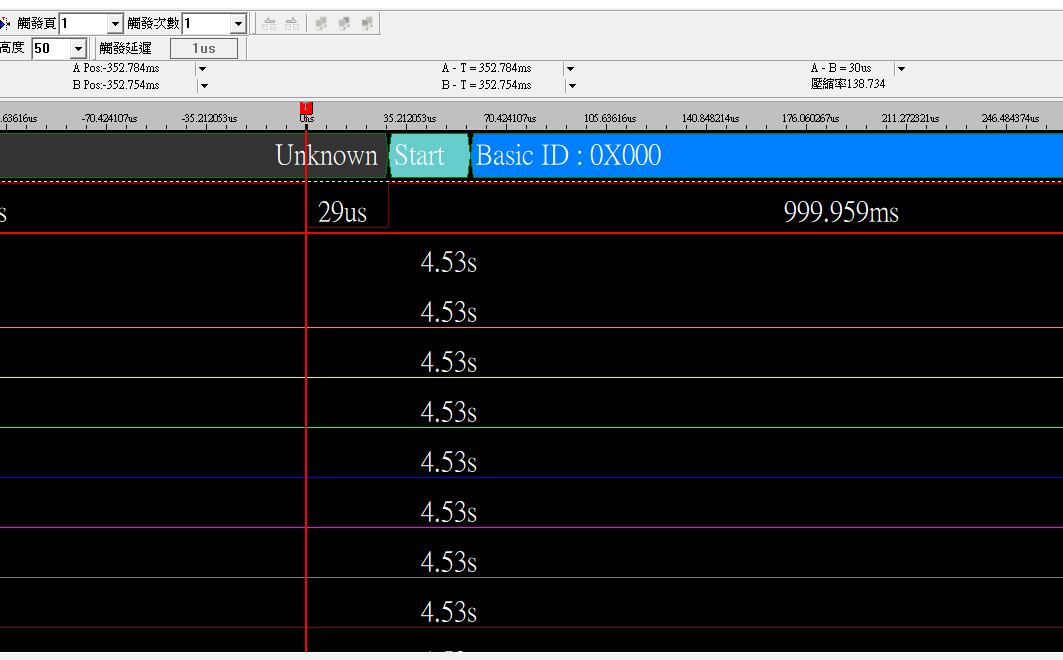

 楼主| 发表于 2024-5-15 11:43:05 | 显示全部楼层
感謝回覆
如圖, 我看邏輯分析的cam_L 看到拉低後拉高, 後續就沒變化
我加入发送空中断, 好像沒回到中斷, 可以麻煩幫我看一下程式, 程式如下

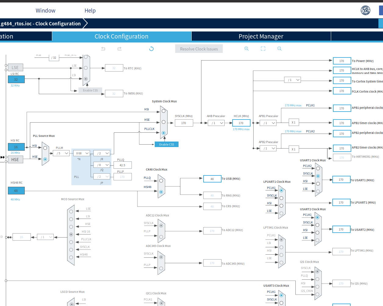

发表于 2024-5-16 08:51:49 | 显示全部楼层
iriss 发表于 2024-5-15 11:43
感謝回覆
你的CAN主时钟配置在那里,也就是你注释上展示的170M,这个是从那个地方配置得出的。
特别注意,这个时钟最好别超过80
38
86
86
 楼主| 发表于 2024-5-16 11:24:49 | 显示全部楼层
void SystemClock_Config(void)
  RCC_OscInitTypeDef RCC_OscInitStruct = {0};
  RCC_ClkInitTypeDef RCC_ClkInitStruct = {0};
  /** Configure the main internal regulator output voltage
  HAL_PWREx_ControlVoltageScaling(PWR_REGULATOR_VOLTAGE_SCALE1_BOOST);
  /** Initializes the RCC Oscillators according to the specified parameters
  * in the RCC_OscInitTypeDef structure.
  RCC_OscInitStruct.OscillatorType = RCC_OSCILLATORTYPE_HSI48|RCC_OSCILLATORTYPE_HSE;
  RCC_OscInitStruct.HSEState = RCC_HSE_ON;
  RCC_OscInitStruct.HSI48State = RCC_HSI48_ON;
  RCC_OscInitStruct.PLL.PLLState = RCC_PLL_ON;
  RCC_OscInitStruct.PLL.PLLSource = RCC_PLLSOURCE_HSE;
  RCC_OscInitStruct.PLL.PLLM = RCC_PLLM_DIV5;
  RCC_OscInitStruct.PLL.PLLN = 68;
  RCC_OscInitStruct.PLL.PLLP = RCC_PLLP_DIV2;
  RCC_OscInitStruct.PLL.PLLQ = RCC_PLLQ_DIV8;
  RCC_OscInitStruct.PLL.PLLR = RCC_PLLR_DIV2;
  if (HAL_RCC_OscConfig(&RCC_OscInitStruct) != HAL_OK)
    Error_Handler();
  /** Initializes the CPU, AHB and APB buses clocks
  RCC_ClkInitStruct.ClockType = RCC_CLOCKTYPE_HCLK|RCC_CLOCKTYPE_SYSCLK
                              |RCC_CLOCKTYPE_PCLK1|RCC_CLOCKTYPE_PCLK2;
  RCC_ClkInitStruct.SYSCLKSource = RCC_SYSCLKSOURCE_PLLCLK;
  RCC_ClkInitStruct.AHBCLKDivider = RCC_SYSCLK_DIV1;
  RCC_ClkInitStruct.APB1CLKDivider = RCC_HCLK_DIV1;
  RCC_ClkInitStruct.APB2CLKDivider = RCC_HCLK_DIV1;
  if (HAL_RCC_ClockConfig(&RCC_ClkInitStruct, FLASH_LATENCY_4) != HAL_OK)
    Error_Handler();

 楼主| 发表于 2024-5-16 15:07:11 | 显示全部楼层
後續我用FDCAN_MODE_EXTERNAL_LOOPBACK檢查, 邏輯分析can tx, 可以看到tx封包, 但改回FDCAN_MODE_NORMAL, tx封包就不對, 連id都錯, 就只改hfdcan1.Init.Mode, ?? 還是還要動哪個參數??
