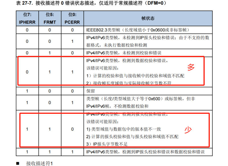

 楼主| 发表于 2025-4-2 10:50:00 | 显示全部楼层
排查出来原因了,接收到了 错误报文,如图两种情况,有多有少

 楼主| 发表于 2025-4-2 13:46:39 | 显示全部楼层
终于跑到100秒了,排查的几点总结:
1. 中断要开启  接收上溢,用于排查是否发生了  这个错误异常,这个异常可能导致  校验错误/phy接收缓存冲毁 等一系列问题,导致丢帧,然后 tcp就认为丢包了
2. 在发现接收上溢的情况后,我增加了接收描述符的配置数量(具体增加多少,可以按是否发生   接收上溢  为依据进行调整;发生就再加点、除非内存不够)
3. 完成以上处理后,我终于跑出了如图的100秒测试,但100秒内仍然发生了8~10次头校验和错误,具体原因不明,下面是手册的解释
IPv4/IPv6类型帧,检测到报头校验和错误。
该错误可能原因:
1) 类型域值与数据包中的版本值不一致
2) 计算的报头校验和值与报头校验和域值不匹配
3)IP报头字节数不足
出错帧的示例数据:
001EC0394D50E4A8DFD1B08A0800450005DCB1B4400040060000C0A8010BC0A8010CE9EC13896E8A4177000019985010FAF08501000030313233343536373839303132333435363738393031323334353637383930313233343536373839303132333435363738393031323334353637383930313233343536373839303132333435363738393031323334353637383930313233343536373839303132333435363738393031323334353637383930313233343536373839303132333435363738393031323334353637383930313233343536373839303132333435363738393031323334353637383930313233343536373839303132333435363738393031323334353637383930313233343536373839303132333435363738393031323334353637383930313233343536373839303132333435363738393031323334353637383930313233343536373839303132333435363738393031323334353637383930313233343536373839303132333435363738393031323334353637383930313233343536373839303132333435363738393031323334353637383930313233343536373839303132333435363738393031323334353637383930313233343536373839303132333435363738393031323334353637383930313233343536373839303132333435363738393031323334353637383930313233343536373839303132333435363738393031323334353637383930313233343536373839303132333435363738393031323334353637383930313233343536373839303132333435363738393031323334353637383930313233343536373839303132333435363738393031323334353637383930313233343536373839303132333435363738393031323334353637383930313233343536373839303132333435363738393031323334353637383930313233343536373839303132333435363738393031323334353637383930313233343536373839303132333435363738393031323334353637383930313233343536373839303132333435363738393031323334353637383930313233343536373839303132333435363738393031323334353637383930313233343536373839303132333435363738393031323334353637383930313233343536373839303132333435363738393031323334353637383930313233343536373839303132333435363738393031323334353637383930313233343536373839303132333435363738393031323334353637383930313233343536373839303132333435363738393031323334353637383930313233343536373839303132333435363738393031323334353637383930313233343536373839303132333435363738393031323334353637383930313233343536373839303132333435363738393031323334353637383930313233343536373839303132333435363738393031323334353637383930313233343536373839303132333435363738393031323334353637383930313233343536373839303132333435363738393031323334353637383930313233343536373839303132333435363738393031323334353637383930313233343536373839303132333435363738393031323334353637383930313233343536373839303132333435363738393031323334353637383930313233343536373839303132333435363738393031323334353637383930313233343536373839303132333435363738393031323334353637383930313233343536373839303132333435363738393031323334353637383930313233343536373839303132333435363738393031323334353637383930313233343536373839303132333435363738393031323334353637383930313233343536373839303132333435363738393031323334353637383930313233343536373839303132333435363738393031323334353637383930313233343536373839303132333435363738393031323334353637383930313233343536373839303132333435363738393031323334353637383930313233343536373839303132333435363738398E14E3B90000E3B9
由于wireshark上的tcp报文大小与此帧的大小不一致,应该是发送方出来的ip分包的原因,所以,很难查出此帧到底是什么原因导致会头校验和错误
但此时,已经不会发生卡死中断测试的情况

 楼主| 发表于 2025-4-3 14:41:04 | 显示全部楼层
硬哥,还是问题找你了
发生四次超时,其中的错误码是 rx描述符的status
0x004E83A0   分析后,错误仍然是
该错误可能原因:
1) 类型域值与数据包中的版本值不一致
3)IP报头字节数不足
这个问题依旧,但现在我是在中间加了路由器的,那至少路由器转板端前是对的,否则,路由器就不会转吧
如果是这样,会不会就是板子有问题,被干扰了?

 楼主| 发表于 2025-4-7 19:06:50 | 显示全部楼层
问题已解决
驱动层的  MAC_CFG.IPFCO ( IP帧数据校验和)改为0,禁止接收端TCP/UDP/ICMP报头的校验和检验功能,就正常了
感觉应该是对端ip分包后,如果开启,会进行硬校验,结果会放在rx描述符中,导致程序判断认为是错误帧:因为ip分包后,第二帧本身就是缺TCP/UDP/ICMP的长度和校验项的
