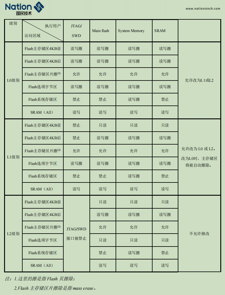

[客户分享] N32G435的选项字节和保护设置

 * @brief  Enables or disables the read out protection.
 * @note   If the user has already programmed the other option bytes before calling
 *   this function, he must re-program them since this function erases all option bytes.
 * @note   This function can be used for N32G43x devices.
 * @param Cmd new state of the ReadOut Protection.
 *   This parameter can be: ENABLE or DISABLE.
 * @return FLASH Status: The returned value can be: FLASH_BUSY, FLASH_ERR_RDKEY,
 *         FLASH_ERR_PG, FLASH_ERR_PV, FLASH_ERR_WRP, FLASH_COMPL,
 *         FLASH_ERR_EV, FLASH_ERR_RDP2 or FLASH_TIMEOUT.
FLASH_STS FLASH_ReadOutProtectionL1(FunctionalState Cmd)
    uint32_t usertmp;
    FLASH_STS status = FLASH_COMPL;
    usertmp = ((OBR_USER_MSK & FLASH->OB) << 0x0E);
    /* Check the parameters */
    assert_param(IS_FUNCTIONAL_STATE(Cmd));
    /* Get the actual read protection L2 Option Byte value */
    if (FLASH_GetReadOutProtectionL2STS() != RESET)
        status = FLASH_ERR_RDP2;
        return status;
    /* Clears the FLASH's pending flags */
    FLASH_ClearFlag(FLASH_STS_CLRFLAG);
    /* Wait for last operation to be completed */
    status = FLASH_WaitForLastOpt(EraseTimeout);
    if (status == FLASH_COMPL)
        /* Authorizes the small information block programming */
        FLASH->OPTKEY = FLASH_KEY1;
        FLASH->OPTKEY = FLASH_KEY2;
        FLASH->CTRL |= CTRL_Set_OPTER;
        FLASH->CTRL |= CTRL_Set_START;
            /* if the erase operation is completed, disable the OPTER Bit */
            FLASH->CTRL &= CTRL_Reset_OPTER;
            /* Enable the Option Bytes Programming operation */
            FLASH->CTRL |= CTRL_Set_OPTPG;
            if (Cmd != DISABLE)
                OBT->USER_RDP = (FLASH_USER_USER & usertmp);
            else
                OBT->USER_RDP = ((L1_RDP_Key & FLASH_RDP_RDP1) | usertmp);
            if (status != FLASH_TIMEOUT)
                /* if the program operation is completed, disable the OPTPG Bit */
                FLASH->CTRL &= CTRL_Reset_OPTPG;
        else
                /* Disable the OPTER Bit */
    /* Return the protection operation Status */
    return status;
 * @brief  Enables or disables the read out protection L2.
FLASH_STS FLASH_ReadOutProtectionL2_ENABLE(void)
    uint32_t usertmp;
    /* Get the actual read protection L1 Option Byte value */
    if (FLASH_GetReadOutProtectionSTS() == RESET)
        usertmp |= (L1_RDP_Key & FLASH_RDP_RDP1);
        return status;
            OBT->USER_RDP = usertmp;
                /* Enables the read out protection L2 */
                OBT->USER2_RDP2 = L2_RDP_Key;
        else
    return status;
