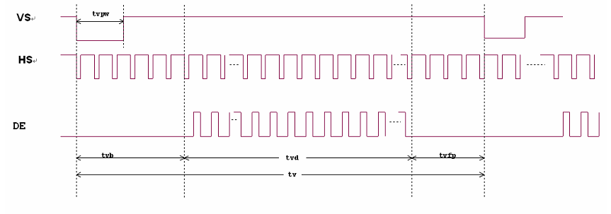

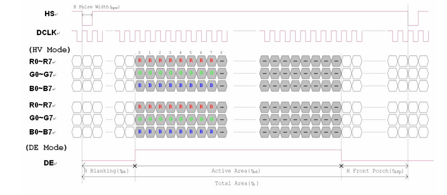

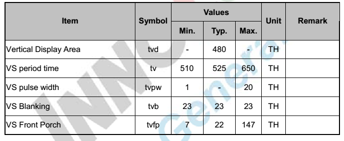

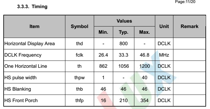

我是用429驱动AT070TN92-800x480 液晶屏
  /* Polarity configuration */
  /* Initialize the horizontal synchronization polarity as active low */
  hltdc_F.Init.HSPolarity = LTDC_HSPOLARITY_AL;
  /* Initialize the vertical synchronization polarity as active low */
  hltdc_F.Init.VSPolarity = LTDC_VSPOLARITY_AL;
  /* Initialize the data enable polarity as active low */
  hltdc_F.Init.DEPolarity = LTDC_DEPOLARITY_AL;
  /* Initialize the pixel clock polarity as input pixel clock */
  hltdc_F.Init.PCPolarity = LTDC_PCPOLARITY_IPC;
1. 通过 上面的图片如何体现出这几个参数全是低电平有效?
2.像素时钟 怎么有的版本是LTDC_PCPOLARITY_IPC参数,有的是LTDC_PCPolarity_IPC 如何通过芯片手册查找这个参数?
Horizontal input timing diagram
Vertical input timing diagram

 楼主| 发表于 2016-1-31 14:37:07 | 显示全部楼层

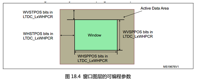

/* Layer1 Configuration ------------------------------------------------------*/
   /* Windowing configuration */
  /* In this case all the active display area is used to display a picture then :
     Horizontal start = horizontal synchronization + Horizontal back porch = 43
     Vertical start   = vertical synchronization + vertical back porch     = 12
     Horizontal stop = Horizontal start + window width -1 = 43 + 480 -1
     Vertical stop   = Vertical start + window height -1  = 12 + 272 -1      */
  pLayerCfg.WindowX0 = 0;
  pLayerCfg.WindowX1 = 480;
  pLayerCfg.WindowY0 = 0;
  pLayerCfg.WindowY1 = 272;
通过上面的图片,horizontal synchronization = 1 , Horizontal back porch=16
Horizontal start = 1 + 16 =17, 这个注释怎么是43呢?

发表于 2016-1-31 15:05:33 | 显示全部楼层
1. 早期的是HV同步模式,现在基本都用DE模式,水平同步和垂直同步取高或者取低没有影响。
2.  LTDC_PCPOLARITY_IPC可能是早期的命名吧,都是大写字母,现在是这个
    LTDC_PCPolarity_IPC

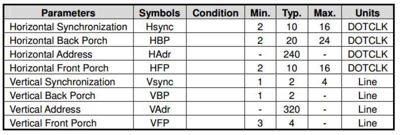

116768
发表于 2016-1-31 15:07:17 | 显示全部楼层
回 beyondabcd 的帖子
beyondabcd:
你给的这个截图看的不太明显啊,可以看我我早期发的这个教程,截图就很容易看出了:
http://www.armbbs.cn/forum.php?mod=viewthread&tid=1958

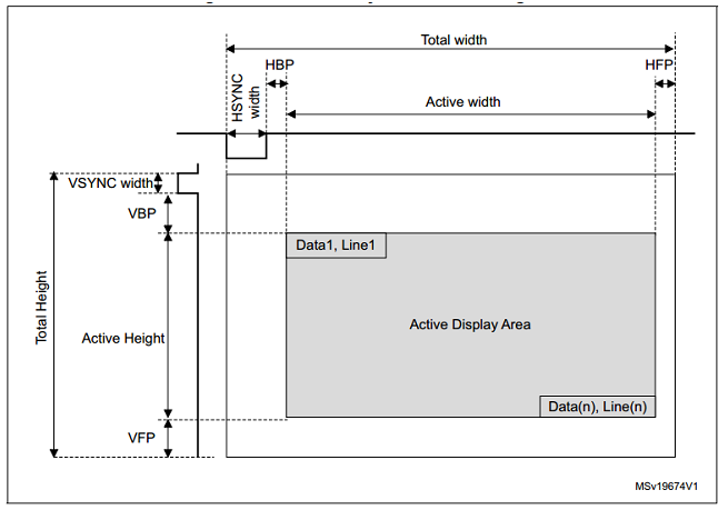

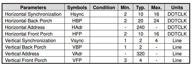

 楼主| 发表于 2016-1-31 20:59:40 | 显示全部楼层
eric2013:
根据下面几张你教程里的图,
horizontal synchronization = 2
Horizontal back porch = 2
Horizontal start = horizontal synchronization + Horizontal back porch= 2 + 2 = 4
这么往里代数,算出来对吗?
