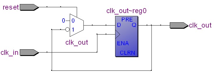

简单的二分频设计,二分频简单的布局布线以后,就是由简单的D触发器实现的。
module verilog_prj(reset,clk_in,clk_out);
input clk_in,reset;
output clk_out;
reg clk_out;
always @(posedge clk_in)
  begin
    if(!reset)  clk_out=0;
    else        clk_out=~clk_out;
  end
endmodule

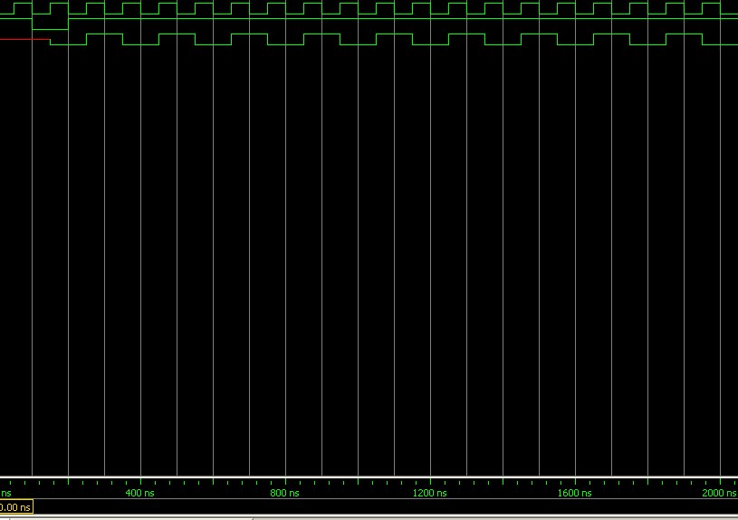

仿真测试模块
`timescale 1 ns/ 1 ps
module verilog_prj_vlg_tst();
// test vector input registers
reg clk_in;
reg reset;
// wires
wire clk_out;
// assign statements (if any)
verilog_prj i1 (
// port map - connection between master ports and signals/registers
    .clk_in(clk_in),
    .clk_out(clk_out),
    .reset(reset)
always  #50  clk_in = ~clk_in;
initial
  begin
     clk_in = 0;
     reset = 1;
    #100 reset = 0;
    #100 reset = 1;
    #10000 $stop;
    #10000 $stop;
end

RTL视图
功能仿真
