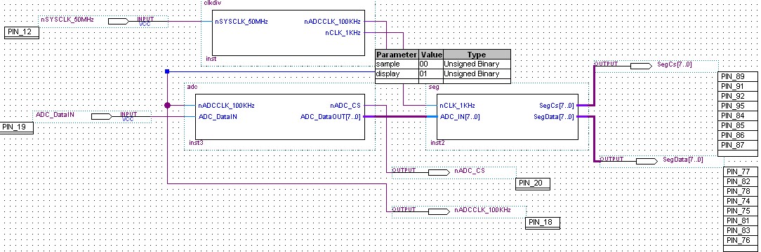

发表于 2013-2-3 12:15:24 | 显示全部楼层 |阅读模式
顶层原理图

 楼主| 发表于 2013-2-3 12:21:25 | 显示全部楼层
Re:CPLD570实验四:ADC TLC549
module adc
    nADCCLK_100KHz,    //TLC549 clk
    ADC_DataIN,        //TLC549 data in
    nADC_CS,           //AD TLC549 cs
    ADC_DataOUT        //TLC549 data out
input ADC_DataIN;
output[7:0] ADC_DataOUT;
output nADC_CS;
input  nADCCLK_100KHz;
/* used for ADC */
reg nADC_CS;
reg[3:0]  cnt;
reg[7:0]  dataout;
reg[7:0] ADC_DataOUT;
/* used for FSM */
reg[1:0]  state;
parameter sample = 2'b00,
          display = 2'b01;
  ADC Program
always@(negedge nADCCLK_100KHz)
   begin
     case(state)
      sample:
       begin
        nADC_CS <= 1'b0;
        dataout[7:0] <= {dataout[6:0], ADC_DataIN};
        if(cnt > 4'd7)
           begin
           cnt <= 4'd0;
           state<=display;
           end
        else
           begin
           cnt <= cnt + 1'b1;
           state <= sample;
           end
        end
       display:
          begin
           nADC_CS <= 1'b1; //关AD片选
              ADC_DataOUT <= dataout;
           //得到采集的数据
           state<=sample;
          end
      default: state<=display;
    endcase
  end
endmodule
