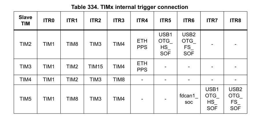

说明:
TIM1作为主控机,配置为PWM模式,通过更新事件作为TIM3和TIM4的触发源。
TIM3和TIM4作为从机,配置为PWM模式,输入触发源是ITR0,由于使用了门控功能,TIM4和TIM3的启动停止全部由TIM1来控制。
TIM1 频率 = TIM1 counter clock / (TIM1_Period + 1) = 781.250 KHz
占空比 = TIM1_CCR1 / (TIM1_ARR + 1) = 50%
TIM3频率 =  (TIM1 frequency)/ ((TIM3 period +1)* (TIM1_Repetition_Counter+1)) = 52.083 KHz
占空比 = TIM3_CCR1/(TIM3_ARR + 1) = 33.3%
TIM4频率 =  (TIM1 frequency)/ ((TIM4 period +1)* (Repetition_Counter+1)) = 78.125 KHz
占空比 = TIM4_CCR1/(TIM4_ARR + 1) = 50%
框图:
代码:

  31.   /* STM32H7xx HAL library initialization:
  32.        - Systick timer is configured by default as source of time base, but user
  33.          can eventually implement his proper time base source (a general purpose
  34.          timer for example or other time source), keeping in mind that Time base
  35.          duration should be kept 1ms since PPP_TIMEOUT_VALUEs are defined and
  36.          handled in milliseconds basis.
  37.        - Set NVIC Group Priority to 4
  38.        - Low Level Initialization
  39.      */
  40.   HAL_Init();
  41.   /* Configure the system clock to 400 MHz */
  42.   SystemClock_Config();
  43.   /* Configure LED3 */
  44.   BSP_LED_Init(LED3);
  45.   /* Timers Configuration */
  46.   /* ---------------------------------------------------------------------------
  47.     TIM1 and Timers(TIM3 and TIM4) synchronisation in parallel mode.
  48.      1/TIM1 is configured as Master Timer:
  49.          - PWM Mode is used
  50.          - The TIM1 Update event is used as Trigger Output
  51.      2/TIM3 and TIM4 are slaves for TIM1,
  52.          - PWM Mode is used
  53.          - The ITR0(TIM1) is used as input trigger for both slaves
  54.          - Gated mode is used, so starts and stops of slaves counters
  55.            are controlled by the Master trigger output signal(update event).
  56.     In this example TIM1 input clock (TIM1CLK) is set to APB2 clock DIV2 (PCLK2),

  124.   TimSlave1Handle.Init.RepetitionCounter = 0;
  125.   if (HAL_TIM_PWM_Init(&TimSlave1Handle) != HAL_OK)
  126.   {
  127.     /* Initialization Error */
  128.     Error_Handler();
  129.   }
  130.   /* Configure the PWM_channel_1  */
  131.   sOCConfig.OCMode     = TIM_OCMODE_PWM1;
  132.   sOCConfig.OCPolarity = TIM_OCPOLARITY_HIGH;
  133.   sOCConfig.Pulse = 1;
  134.   if (HAL_TIM_PWM_ConfigChannel(&TimSlave1Handle, &sOCConfig, TIM_CHANNEL_1) != HAL_OK)
  135.   {

发表于 2024-10-1 23:54:42 来自手机 | 显示全部楼层
请问下H7的T2好像不能通过内部触发到T5,F4可以,因为T2孟触发到T5就可以一个精密的到USEC 一个到SEC
116761
 楼主| 发表于 2024-10-2 09:04:58 | 显示全部楼层
你说的是不是这个图
32
32
32
发表于 2024-10-2 21:59:04 来自手机 | 显示全部楼层
嗯,就是这个图
