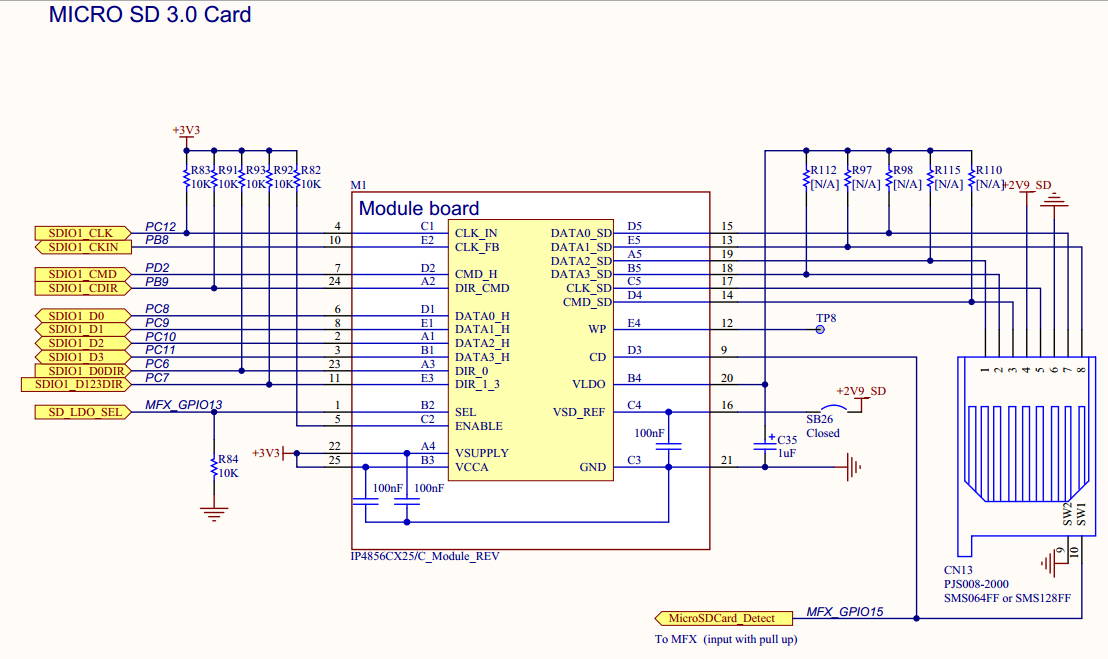

发表于 2018-9-28 11:25:17 | 显示全部楼层 |阅读模式
硬件接线图,官方综合评估板:
115728
 楼主| 发表于 2018-9-28 11:52:28 | 显示全部楼层

注意引脚的复用设置,有GPIO_AF7_SDIO1,GPIO_AF8_SDIO1和GPIO_AF12_SDIO1

  26.   /* D0(PC8), D1(PC9), D2(PC10), D3(PC11), CK(PC12), CMD(PD2) */
  27.   /* Common GPIO configuration */
  28.   gpio_init_structure.Alternate = GPIO_AF12_SDIO1;
  29.
  30.   /* GPIOC configuration */
  31.   gpio_init_structure.Pin = GPIO_PIN_8 | GPIO_PIN_9 | GPIO_PIN_10 | GPIO_PIN_11 | GPIO_PIN_12;
  32.   HAL_GPIO_Init(GPIOC, &gpio_init_structure);
  33.   /* GPIOD configuration */
  34.   gpio_init_structure.Pin = GPIO_PIN_2;
  35.   HAL_GPIO_Init(GPIOD, &gpio_init_structure);
  36.   /* D0DIR(PC6), D123DIR(PC7) */
  37.   gpio_init_structure.Alternate = GPIO_AF8_SDIO1;
  38.   /* GPIOC configuration */
  39.   gpio_init_structure.Pin = GPIO_PIN_6 | GPIO_PIN_7;
  40.   HAL_GPIO_Init(GPIOC, &gpio_init_structure);
  41.   /* CKIN(PB8), CDIR(PB9) */
  42.   gpio_init_structure.Alternate = GPIO_AF7_SDIO1;
  43.   /* GPIOB configuration */
  44.   gpio_init_structure.Pin = GPIO_PIN_8 | GPIO_PIN_9;
  45.   HAL_GPIO_Init(GPIOB, &gpio_init_structure);
