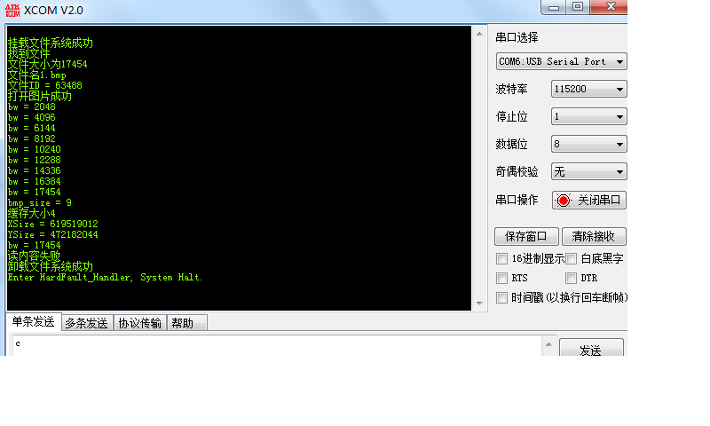

项目要求:给NANDFALSH做了RL-FLASHFS文件系统,同时使用EMWIN,通过RL-USB模拟U盘,在PC端将MBP图片导入到模拟的U盘,关闭模拟U盘后,在429上通过文件系统读取该图片,通过EMWIN在屏幕上刷图片,,
问题现象:PC端能正确识别模拟好的U盘,初始化等都没问题,但在429上读取图片再用EMWIN刷图时,老是进入硬件错误Enter HardFault_Handler, System Halt.
100*50的图片,有时候能成功显示,有时候不行,800*480每次都失败。哪位大神做过leisi
附上关键代码:(前面的while(1)是为了方便格式化和模拟U盘用的,图片通过PC端复制进去之后不再用,,,测试代码)

void Show_Bmp(unsigned char *pic_dir)
        GUI_MEMDEV_Handle hMemBMP;
        uint32_t t0, t1, i, count = 0;
        char buf[50];
        GUI_DispStringAt("Load BMP File to Memory Devices....", 10, 10);
        /* 加载BMP图片到内存设备 */
        hMemBMP = _ShowBMP2(pic_dir, 0, 0);
        /*刷新20次,串口打印速度数值,时间单位ms */
        for(i = 0; i < 1; i++)
                t0 = GUI_GetTime();
                /* 用到BMP图片的时候,调用此函数即可 */
                GUI_MEMDEV_WriteAt(hMemBMP, 0, 0);
                t1 = GUI_GetTime() - t0;
                printf("速度 = %dms\r\n", t1);
                count += t1;
        /* 求出刷新20次的平均速度 */
        sprintf(buf, "speed = %dms/frame", count/i);
        GUI_DispStringAt(buf, 10, 10);
GUI_HMEM _ShowBMP2(const char *sFilename, int x, int y)
        u8 *_acBuffer;
        int XSize, YSize;
        uint32_t bw = 0;
        FILE *fin;
        FINFO info;
        unsigned char result = 0;
        u32 bmp_size;
        u32 i = 0;
        GUI_HMEM hMem;
        info.fileID = 0;
        result = ffind ((const char *)sFilename, &info);
        if(result==0)
                printf("找到文件\r\n");
                printf("文件大小为%d\r\n",info.size);
                printf("文件名%s\r\n",info.name);
                printf("文件ID = %d\r\n",info.fileID);
        else
                printf("未找到文件\r\n");
        bmp_size = info.size/NAND_PAGE_SIZE;
        bmp_size += 1;
        /* 打开文件 */
        fin = fopen(sFilename,"r");
        if (fin != NULL)
                printf("打开图片成功\r\n");
                /* 申请一块内存空间 并且将其清零 */
                hMem = GUI_ALLOC_AllocZero(info.size);
                /* 将申请到内存的句柄转换成指针类型 */
                _acBuffer = GUI_ALLOC_h2p(hMem);
                /* 读数据 */
                if(bmp_size==1)
                        bw = fread(_acBuffer, 1, info.size, fin);
                else
                        for(i=0;i<bmp_size;i++)
                                bw += fread(_acBuffer, 1, NAND_PAGE_SIZE, fin);
                                printf("bw = %d\r\n",bw);
                                _acBuffer += NAND_PAGE_SIZE;
                                info.size -= NAND_PAGE_SIZE;
                                if(info.size<NAND_PAGE_SIZE)
                                        bw += fread(_acBuffer, 1, info.size, fin);
                printf("bmp_size = %d\r\n",bmp_size);
                bsp_DelayMS(200);
                XSize = GUI_BMP_GetXSize(_acBuffer);
                YSize = GUI_BMP_GetYSize(_acBuffer);
                printf("XSize = %d\r\n",XSize);
                printf("YSize = %d\r\n",YSize);
                if(bw == info.size)
                        printf("读内容成功\r\n");
                        hMemBMP = GUI_MEMDEV_CreateEx(0, 0, XSize, YSize, GUI_MEMDEV_HASTRANS);
                        GUI_MEMDEV_Select(hMemBMP);
                        GUI_BMP_Draw(_acBuffer, 0, 0);
                        GUI_MEMDEV_Select(0);
                        /* 释放动态内存hMem */
                        GUI_ALLOC_Free(hMem);
                        /* 关闭文件 */
                        fclose(fin);
                        result = funinit("N0:");
                        if(result != NULL)
                                printf("卸载文件系统失败\r\n");
                        else
                                printf("卸载文件系统成功\r\n");
                        return hMemBMP;
                else
                        printf("读内容失败\r\n");
                        fclose(fin);
        else
                printf("打开文件失败\r\n");
        /* 卸载NAND Flash */
        if(result != NULL)
        else

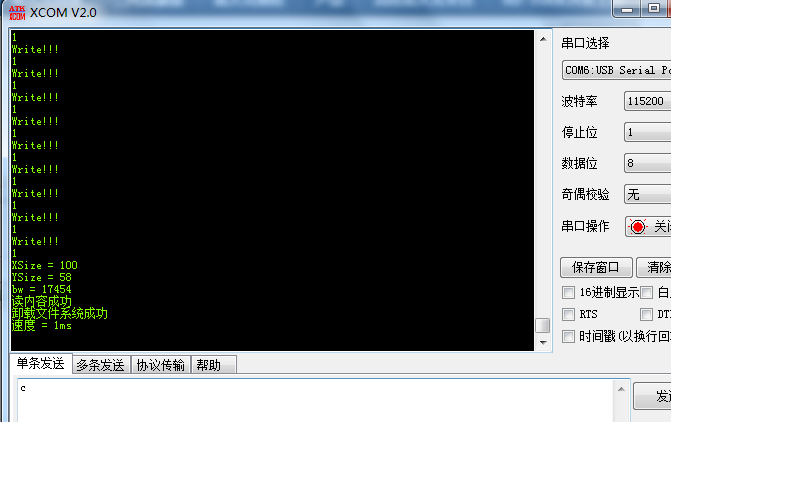

 楼主| 发表于 2018-12-11 16:51:45 | 显示全部楼层
100*58的图片刷出来了,但不知道为什么我只是用fread读图片,调试串口竟然出现了“写”NANDFLASH的打印信息,而且每次上电读几次之后,图片有些像素点颜色变了,我怀疑就是那个“写”操作导致数据丢失了,但是找不到哪里执行写操作了
