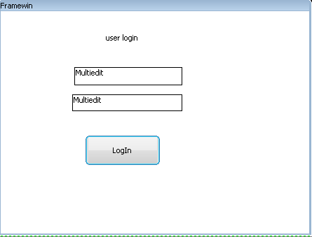

  { FRAMEWIN_CreateIndirect, "Framewin", ID_FRAMEWIN_0, 1, 3, 450, 340, 0, 0x0, 0 },
  { BUTTON_CreateIndirect, "Button", ID_BUTTON_0, 121, 178, 106, 42, 0, 0x0, 0 },
  { MULTIEDIT_CreateIndirect, "Multiedit", ID_MULTIEDIT_0, 105, 80, 154, 26, 0, 0x0, 0 },
  { MULTIEDIT_CreateIndirect, "Multiedit", ID_MULTIEDIT_1, 102, 119, 157, 24, 0, 0x0, 0 },
  { TEXT_CreateIndirect, "Text", ID_TEXT_0, 150, 31, 80, 20, 0, 0x64, 0 },
  // USER START (Optionally insert additional widgets)
  // USER END
各位大神:
我在设计一个登陆界面,我想把背景搞成纯白的,不要有Framewin 这样菜单栏的样子怎么办,我是初学小白,望多多指教,谢了
把上面的 FRAMEWIN_CreateIndirect 换成 WINDOW_CreateIndirect
设置背景用 WINDOW_SetBkColor 函数

谢谢   搞定!
