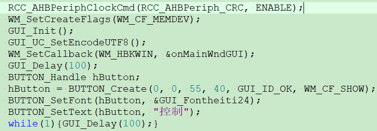

STemWin5.44 的问题搞得头都大了,请教下各位:

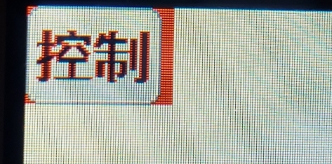

使能存储设备或者缓存后小工具TEXT和BUTTON等的反锯齿文字都显示异常了
使能存储设备时,文字显示了背景的颜色:
程序:

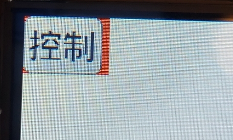

删除WM_SetCreateFlags(WM_CF_MEMDEV);时:
硬件stm32f103VE+ILI9488,52K ram
  1. void LCD_X_Config(void) {
  2.   GUI_DEVICE * pDevice;
  3.   CONFIG_FLEXCOLOR Config = {0};
  4.   GUI_PORT_API PortAPI = {0};
  5.   //
  6.   // Set display driver and color conversion
  7.   //
  8.   pDevice = GUI_DEVICE_CreateAndLink(GUIDRV_FLEXCOLOR, GUICC_565, 0, 0);
  9.   //
  10.   // Display driver configuration, required for Lin-driver
  11.   //
  12.   LCD_SetSizeEx (0, XSIZE_PHYS , YSIZE_PHYS);
  13.   LCD_SetVSizeEx(0, VXSIZE_PHYS, VYSIZE_PHYS);
  14.   //
  15.   // Orientation LCD_SetDevFunc
  16.   //
  17.   Config.Orientation = GUI_SWAP_XY | GUI_MIRROR_Y | GUI_MIRROR_X;
  18.   Config.NumDummyReads = 1;
  19.   GUIDRV_FlexColor_Config(pDevice, &Config);
  20.   //
  21.   // Set controller and operation mode
  22.   //
  23.   PortAPI.pfWrite8_A0  = LcdWriteReg;
  24.   PortAPI.pfWrite8_A1  = LcdWriteData;
  25.   PortAPI.pfWriteM8_A1 = LcdWriteDataMultiple;
  26.   PortAPI.pfReadM8_A1  = LcdReadDataMultiple;
  27.   GUIDRV_FlexColor_SetFunc(pDevice, &PortAPI, GUIDRV_FLEXCOLOR_F66709, GUIDRV_FLEXCOLOR_M16C0B8);
  28. }
