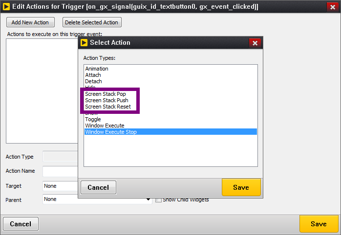

GUIX Studio里面有这个:
查阅了下,这是仅有的资料:
大概看了下,貌似意思是说各种控件状态的上下文切换。
38

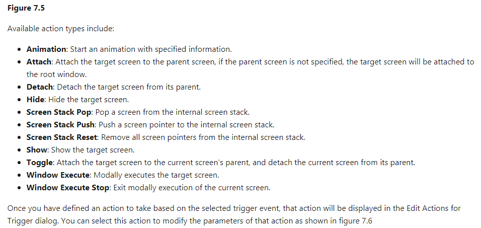

发表于 2020-9-15 14:20:45 | 显示全部楼层
Animation: Start an animation with specified information. Attach: Attach the target screen to the parent screen, if the parent screen is not specified, the target screen will be attached to the root window. Detach: Detach the target screen from its parent. Hide: Hide the target screen. Screen Stack Pop: Pop a screen from the internal screen stack. Screen Stack Push: Push a screen pointer to the internal screen stack. Screen Stack Reset: Remove all screen pointers from the internal screen stack. Show: Show the target screen. Toggle: Attach the target screen to the current screen's parent, and detach the current screen from its parent. Window Execute: Modally executes the target screen. Window Execute Stop: Exit modally execution of the current screen.
38
47
47
发表于 2020-9-15 14:22:08 | 显示全部楼层
https://docs.microsoft.com/zh-cn/azure/rtos/guix/guix-studio-7
这里有对这几个选项的解释。
